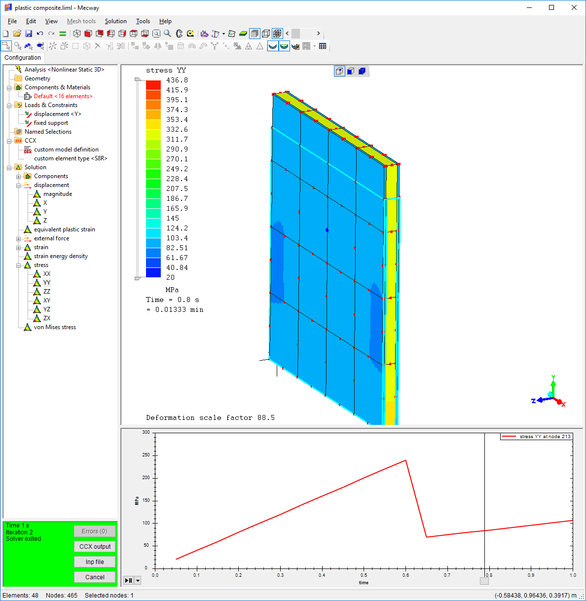

The CCX solver looks like it can if you define the brittle material using a plastic stress-strain curve which drops to zero stress after the failure strain. Here's an example of a sandwich material. The solution shows that the stress in the brittle layers drops when they fail but not all the way to zero which is strange. So I'm not sure if this is quite right.

A ) Changed the fixed support to get rid of the stress singularities at the ends. Might not really be practical for a real structure. (plastic composite v3.liml)
B ) Added another stress-strain point to the brittle material data to give it a small non-zero stiffness after yield. This seems to solve the convergence problem. I put it at a huge plastic strain of 1 so that there'll be some slope to the curve for all realistic strains. (plastic composite v4.liml)
I notice you have a zero-slope curve for the ductile material too. That's usually risky and it might fail in other cases although it seems to be OK here.
I think the reason the stress might not going to zero after failure could be that the values are extrapolated from the integration points and then averaged between elements so a single point failure could be disguised by the non-yielded points around it.
