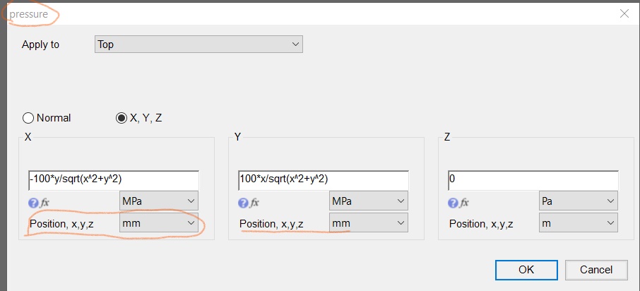

¿What does the reference to the length units of the Pressure menu refer to? View image.
I want to apply them to the edge of a Shell element.
¿Would it be a Line Pressure?
Thanks in advance

Those are the units for x,y,z used in the formula.
Line pressure is force per unit length instead of area. You can use either on the edge of a shell with the internal solver but only pressure with CCX.
