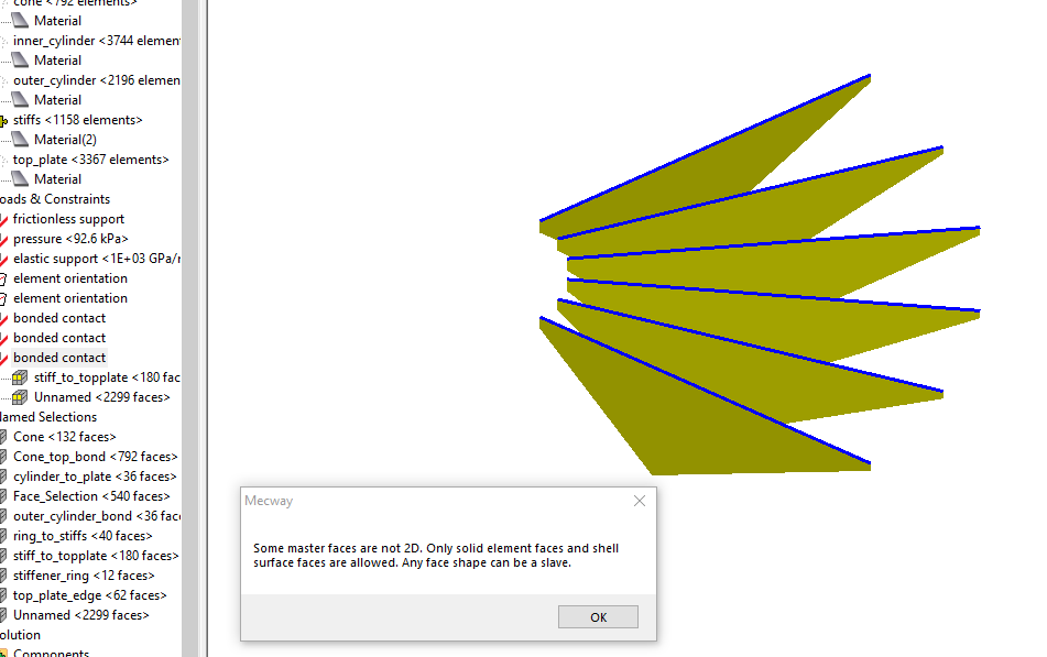

Bonded contact error
see attach file and screen capture. Does anyone know what is causing this error.
If I swap the master and slave the error goes away. Is it okay to swap them?
  • Yes, shell edges have to be the slave. The should also be not much longer than the master faces to ensure all master nodes are connected to a slave node.
