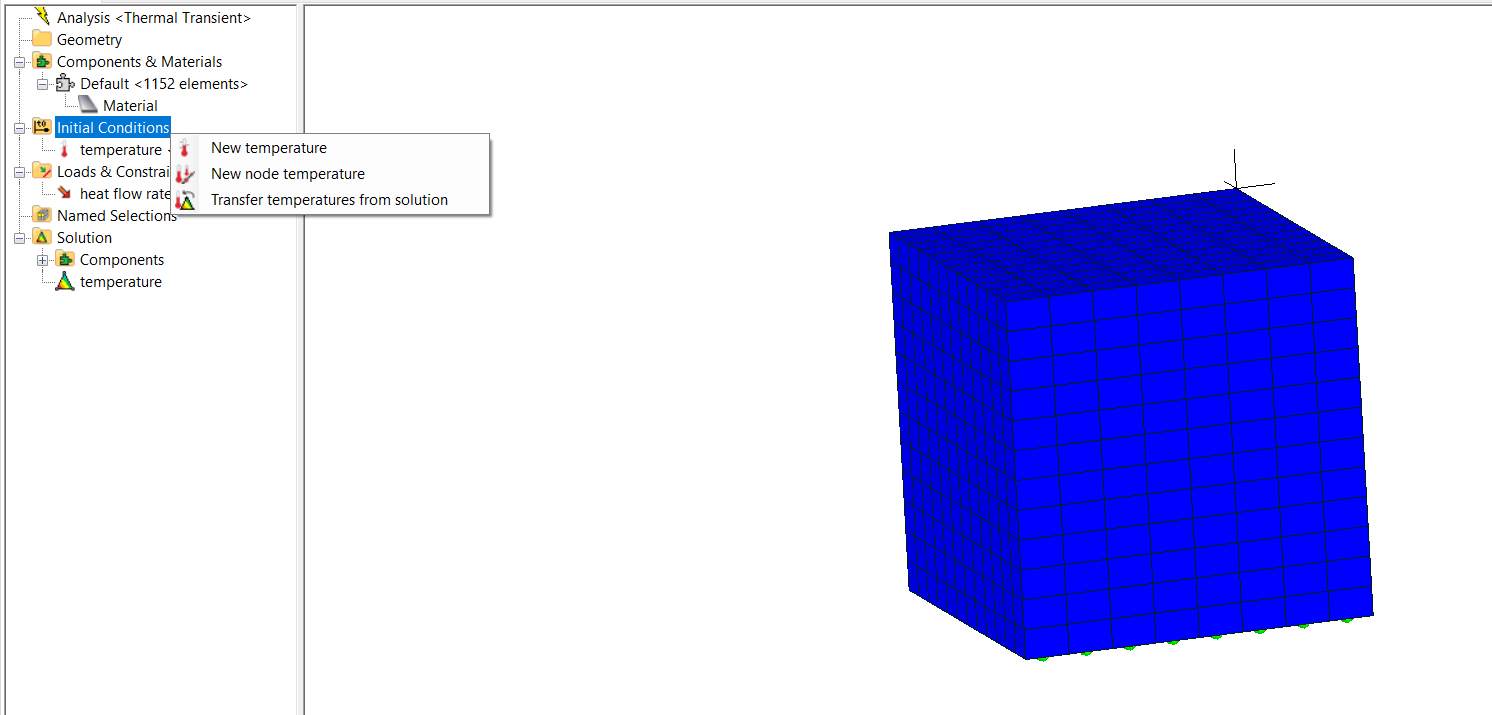

    You may also want to set an initial temperature on all elements instead of the default which is 0 K (-460 F). Select all elements, then right click Initial Conditions in the outline tree, and pick New temperature.

    Is it still possible to add an initial temperature? I seem to be either missing the option or more likely I have missed something.

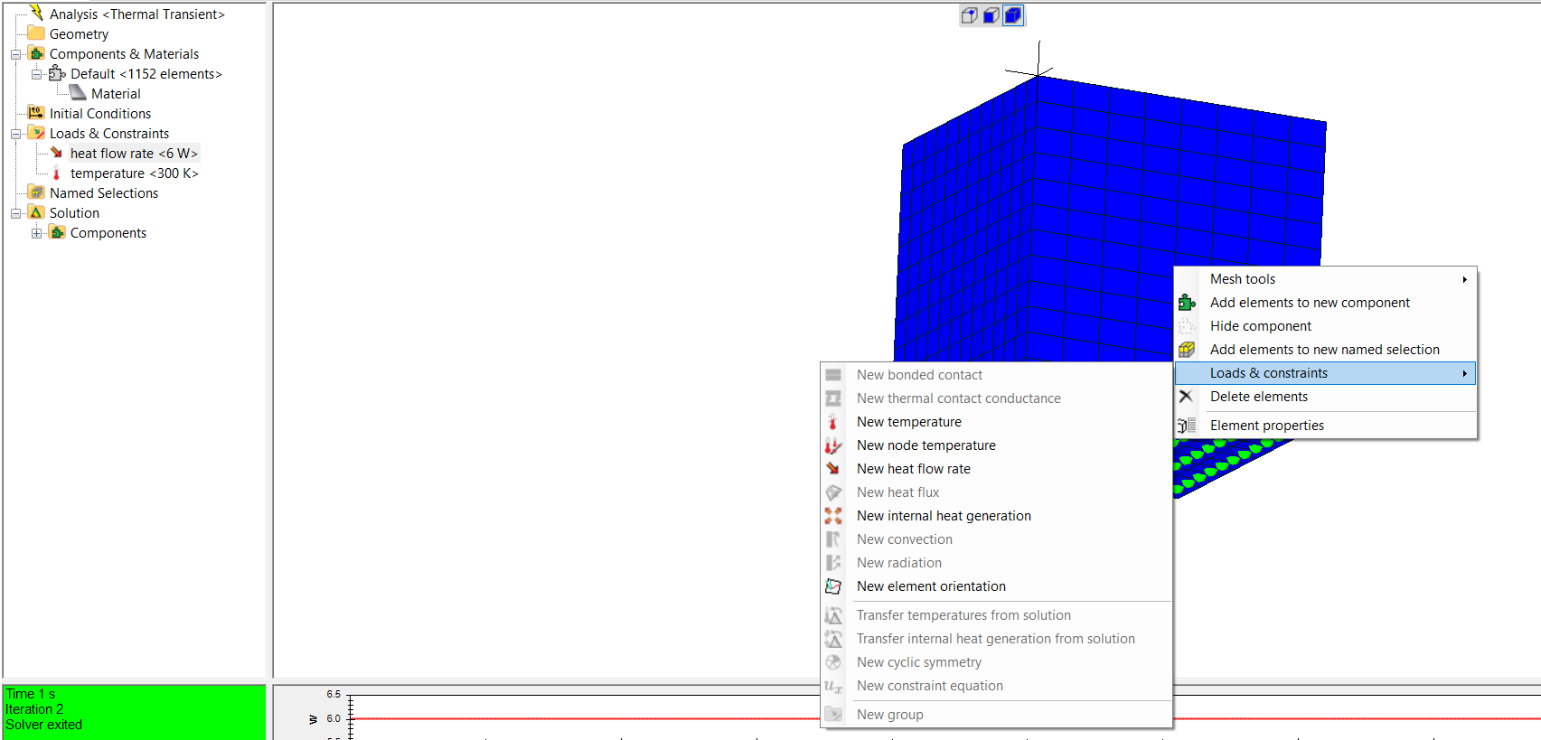

  • Okay - the solution in case someone else comes looking is to select the elements then right click the initial conditions in the left panel and then you can add in the initial temperature.
    Personally I think would be good to also have the initial conditions section in the right click menu but glad I got it working!
