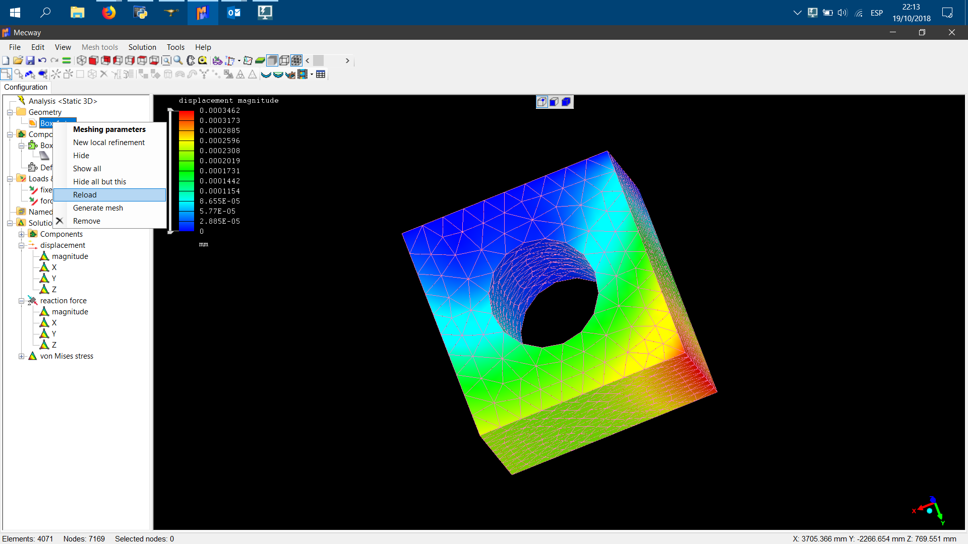

  • As far as I know is perfectly possible, even if you don´t add or remove features (faces), the boundary conditions should keep in place. Just be sure to add the bc based on faces of the step, and not of the mesh. In case the bc were not reatached to the new geometry is just a matter of reassign to the new faces.
  • Modify the step file with your favorite software, save it with the same name and in the same place as the original and then "reload" the geometry in the geometry menu in Mecway.
    Do nor import as new Step, just reload.
    As Sergio said be sure to add the bc based on faces of the step.
