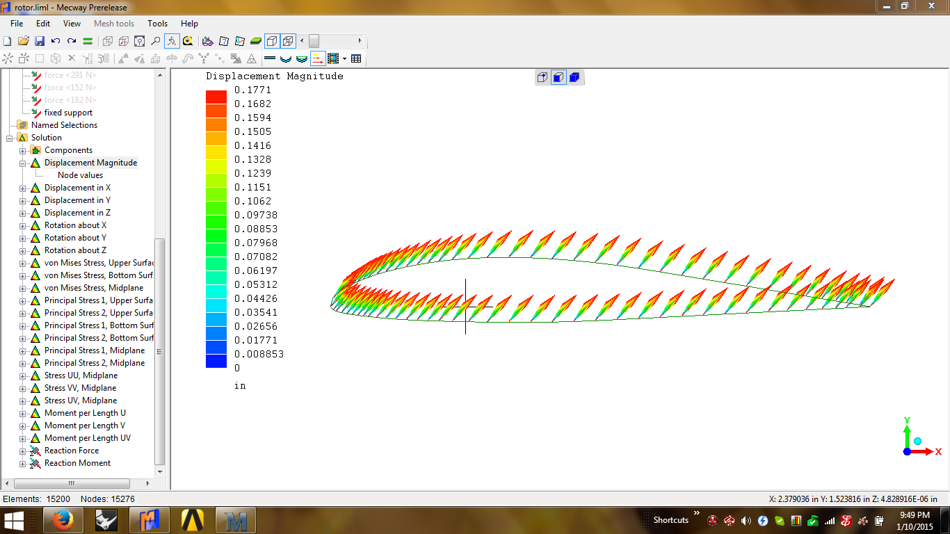

I have a rotor blade made from shell elements. I have specified it to rotate around the y-axis at ~500rpm. I run the simulation and the reactive forces at the anchored nodes look reasonable. I then add some lifting forces along the length of the blade. The blade appears to deflect under those lifting forces as if there are no corrective centrifugal forces acting on the blade (the centrifugal forces should act to reduce the deflection caused by the lifting forces). If I turn off the centrifugal force the deflection is virtually unchanged. How do I get the centrifugal forces to act on each element?

  • i ran your model and the results seem odd. The aero loads seem to be working. But the centrifugal load doesn't make sense. Not sure what is wrong but the model isn't moving in the direction you would think. It should be stretching along Z to me. I don't know if it is your boundary conditions or not. Rather than fixed boundary you have displacements set to zero. I don't know Mecway well enough to modify your model but I would try fixed boundary conditions just to be sure. Other than that maybe something isn't setup right. I can see the shell model is probably ok in your case since you are modeling a hollow blade. I was think of a solid blade. But your model the aero and the centrifugal are moving the blade in similar directions, so that is why you aren't seeing the combination of them. I turned off all the aero loads to see what the centrifugal was doing by itself. I'm assuming you have the model centered at the origin and are trying to spin it about the y-axis from what I saw.

    hmm, interesting. i tried changing the boundary condition to fixed. turned out to be easy to do. the results seem to be the same. then i looked at your airfoil and see. i was thinking it's symmetrical. but it's heavy on the top compared to the bottom and heavy on the trailing edge to the leading edge. so that is probably why it is moving the way it is. surprisingly little z axis movement though. in any event, as is, the aero and centrifugal are moving the blade in pretty similar directions. i haven't run a blade shape like that before, interesting how different it moves under load. the aero loads really bend it. if you were to move the rotor so that the origin (0,0,0) was at the center of mass of the airfoil, then it should stretch along z and move more like what you want.
  • Since this is a linear static analysis, all forces act as if the blade is in the undeformed shape. The centrifugal force doesn't try to straighten it when it's bent by the lateral forces. You would have to do a nonlinear analysis for that. Unfortunately Mecway doesn't support the combination of features that would solve this problem conveniently. One way would be to extrude the shells to solid elements, use nonlinear analysis, and simulate centrifugal force by using gravity with several materials of different density along the radius.
    As for the deflection being in a strange direction with just the centrifugal force, it seems reasonable because of the asymmetry you mentioned prop_design. I'm not entirely confident that means there must be bending though since the greater mass should be balanced by a proportionally greater tensile stiffness.

    Here are some examples to help clarify what I mean about aligning the center of mass of the blade to the axis of rotation. You can see if it is perfectly aligned you get pure tension along the z-axis (from the test.liml file). If you move the blade off to one side you get the sideways force (from the test 2.liml file). If you constrain the model at the axis of rotation and move the model off to one side you get bending in two directions (from the test 3.liml file). Test 3 is similar to the original model posted here, in that the cm is off axis in two directions and the model is fixed at the axis of rotation. Hope these help clarify the situation some.
    As Victor noted, to fully see what you were originally going for, you would also have to do a nonlinear analysis. But you have to get your centrifugal load working in the correct direction first.
    I cleared the results to reduce the file size. Simply re-solve to see the results, everything else is setup. I provided the step files just in case you wanted them for other purposes.

  • looking at this more it seems like the cm of your blade is in the +x, -y quadrant. the attached model simulates closer what the resultant motion of this is. i keep thinking your model is solid. so that is why the cm is where it is, because the model is not solid.
    it doesn't seem like anything is wrong with mecway or your original model. the model seems to be moving the way it should given how it's setup. if you do the nonlinear analysis, you won't get the coupling your hoping for without moving the blade cm/cg to the axis of rotation.
  • edited January 2015
    The biggest problem you have right now with the way it's setup is you are not getting the benefit of the centrifugal stiffening. If the blade is oriented properly the blade will stretch. This makes it much stiffer to loads in the perpendicular direction to the centrifugal stiffening. So right now your model is moving a lot from the aero loads. You should be getting so much stiffening from the centrifugal loads that it helps reduce the deflection from the aero loads. This would be evident, even in a static analysis.
    Also if you view your model with thicken enabled you can see the trailing edge overlaps. This is the type of thing you can run into with shell models. Solid models prevent any kind of inadvertent errors like that. Every element is in the right place and has the right mass. That is not always the case with shell elements. But I understand about heading towards composites. Those are a whole other beast.

    Appreciate your comments. The whole purpose of this particular simulation was to explore the effects of centrifugal stiffening. It would seem to me that if the blade is undeflected in the static analysis, then the lift forces will be orthogonal to the inertial forces, hence the inertial forces will NOT provide any blade stiffening - hence the need for the non-linear simulation. Am I off base here?
    I was aware the trailing edge overlapped, but it was a compromise I had determined I could live with - the mesh was generated by "hand" - actually I wrote a little script to translate the airfoil data into the xml format that could be read by MECWAY. This gave me a highly consistent mesh.

  • so here is some tests i did to try and answer the nonlinear vs linear question. it does seem like you have to do a nonlinear analysis, like victor said. i am surprised by this, however, i don't know the fea theory that well. the linear just seems to add the stress states more or less. when you do the nonlinear, you get the displacement reduction you expect. this is an ideal case of a symmetrical object. so the cg of the object is inline with the centrifugal force. even in your case of a blade with no twist, the airfoil is not truly symmetric. so you won't achieve ideal results. but it is still better to align the cg of the part to the spin axis. in any event, it seems like mecway does not allow shell elements in a nonlinear analysis. another oddity is that the mecway shell model is producing different results than the solid model. so it is obscuring the comparison. if you look at the case of the shell with bending force compared to the solid with bending force, that difference is throwing off the comparison some. but if you look at the solid model linear vs nonlinear, nonlinear seems to be the more accurate of the two. the test model is too big, that is why the rpm is so low. you would need to shrink the model to get the rpm up to a normal level. however, for test purposes, i don't think it matters much. once again the mecway results are virtually the same as the ansys results.
    so to try and answer your original post. use solid elements in a nonlinear analysis. align the blade cg to the axis of rotation. if the blade is at an angle of attack and/or there is blade twist, the deflections due to centrifugal force is a lot different than a symmetrical object. so you need to do some tests to get your brain around it. it's hard to explain without you seeing it for yourself. but in comparisons i have done; whether the blade is at an angle of attack and/or you have blade twist, it is still better to align the cg of the blade to the axis of rotation (as opposed to the aerodynamic center or some other random point). aligning the cg to the axis of rotation maximizes the benefit of centrifugal force.

    Here is an updated shell model. I re-did it and the results are more sensible. I was getting these same results before they shifted to the values in the previous post. Not sure what is different. Pretty weird. But the solid model would be the way to go. This is more academic than anything. Same step file was used as the previous post.
