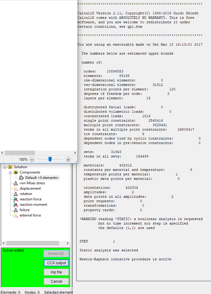

    Now I've run the simulation. It seems it solves it, but I don't see any results. Looks like the simulation has no components in it? What's wrong?
  • It looks like CCX crashed. I think that can happen with a too big model but also for other reasons. You might need to reduce the number of nodes or at least eliminate parts to identify what causes the failure.
