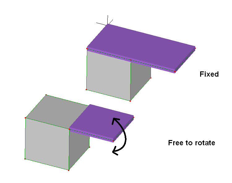

You can simply merge the nodes, yes. That will create a hinge joint because an individual node of a solid element can't transmit moments.
If you want a stiff joint, for now, you have to connect the shell across several nodes so that together they prevent free rotation.
