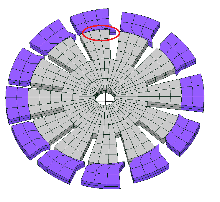

When bonded contact or constraint equations are used with cyclic symmetry and modal vibration together, their slave nodes have incorrect displacements. The other nodes' displacements and the frequencies are still correct.
The effect is visible as tearing in the deformed view as shown in the attachment.
