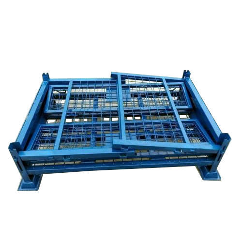

I cant post the problem as the project is confidential but its a simple foldable pallet.The problem is occuring in the contact between the surfaces of 3D solid and shell elements.
Victor Help me out here I was really impressed with mecway so I bought it and now its giving this vague problems and I keep pushing my deadline.
