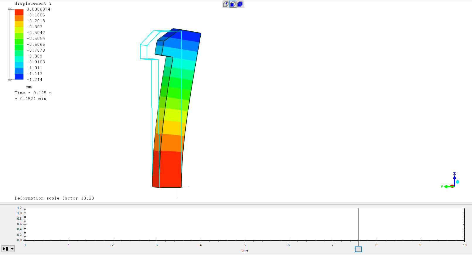

Shift between the time bar and the time counter
Minor issue but I have noticed a shift between the time bar and the time counter.
In the picture there is a time period of 10 sec with time step of 1 sec. (Automatic time stepping ) . Video velocity 10 seconds.
Same shift with Automatic time stepping unchecked.
  • It's supposed to show the nearest time step that exists in the solution. It doesn't interpolate between them or anything like that so they often won't have the exact same value. With automatic time stepping, they can be spaced quite far apart. The value 9.125 s looks like a typical automatic time step result from CCX after 5.75 s, so choosing 7.6 s with the slider would cause it to show the higher one because it's closer.
    If there are other time steps in the solution closer to where the slider is, then that's probably a bug. But I can't reproduce it so please send the file.
  • It is showing the nearest time step that exists in the solution.
