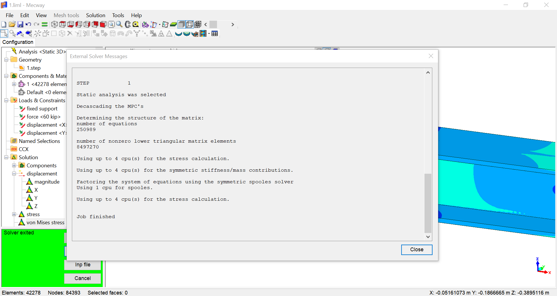

  • Victor,
    It looks like your included ccx version 2.11 is multi-threading although it didn't labeled with "MT". The "CCX Output" showed multiple CPU being used.
    I checked/compared yours against Kwip's complied ccx_2.14_MT on many different linear static analysis and the results are about the same and as fast to solve.
    I also re-checked the linear buckling inconsistent issues we had with "MT" ccx version and it still exist for Kwip's ccx_2.14_MT but doesn't exist for your "ccx.exe". Your are consistent when I run multiple times (more than 10 times with 10 modes). This is great news.
  • Thanks for the comparisons. It's not supposed to be compiled with the multithreading option so I don't know what's happening there.
    It's based on the General Electric version. I heard from a former colleague of the guy who compiled it that he's quite smart :)

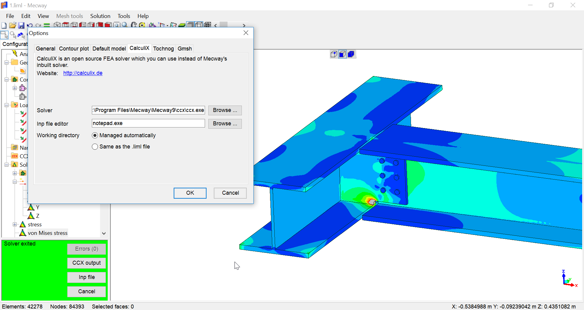

  • Attached are the screenshots of ccx.exe directory and ccx output showing I was using the stock ccx and multiple cpu being used.
    If someone can also verify this, it would be great.
  • I think that message might just be reflecting the OMP_NUM_THREADS environment variable. When I change that, it changes the number in the message to match but I still see only 25% CPU usage on my 4-core computer when CCX says "up to 4 cpu(s)".
  • I see now. I went back and rerun a large model with about 324k nodes and 8 contacts. ccx.exe took about 5min and ccx2.14_MT took about 3min to solve. Also looked at the CPU usage. ccx2.14_MT used almost at 100% (when using all threads) while ccx.exe didnt.
