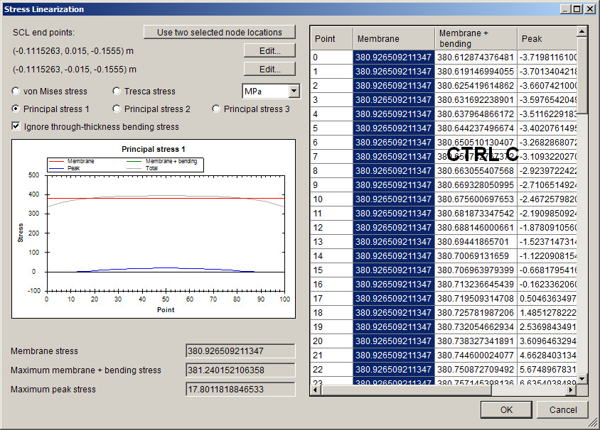

Hi, is possible to export the results table of the stress linearization as csv or txt???
Andrea
January 2018
I select all variables ( or single column) on the SL table - CTRL+C- CTRL+V on excel
Andrea
January 2018
Example
276.8K
Sergio
January 2018
Thanks!
