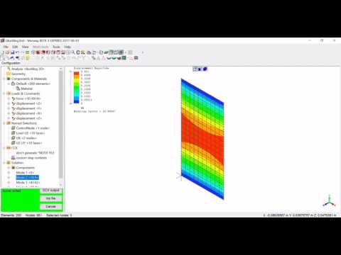

Solving the same model several times the results are different. For simple model is possible to understand that the solution is wrong but for complex model is better to avoid this solver.
See attached pictures.
I attach liml file.
I will try the ccx.exe from kwip.....same problem
Run several times the solver
Try to check also high eigenvalues
https://youtu.be/EjBBlOg1QKE
