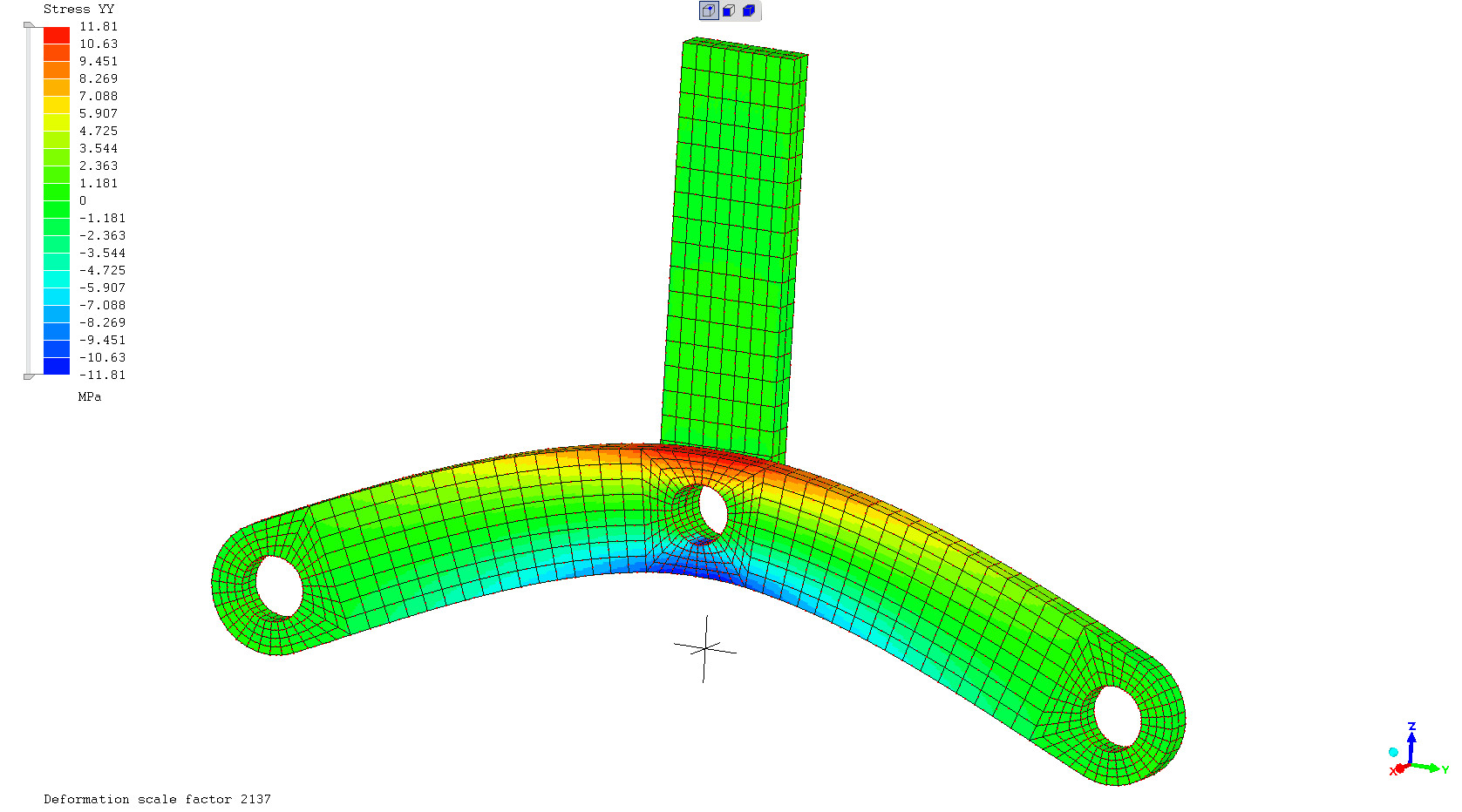

I found an interesting example how to apply DCOUP3D element to join cylindrical surface.

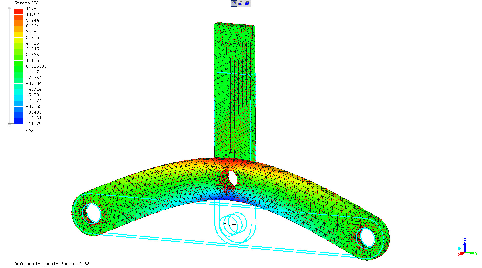

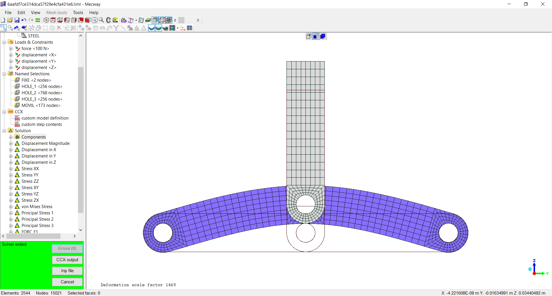

I replicated this example in a more simple model trying different types of mesh:

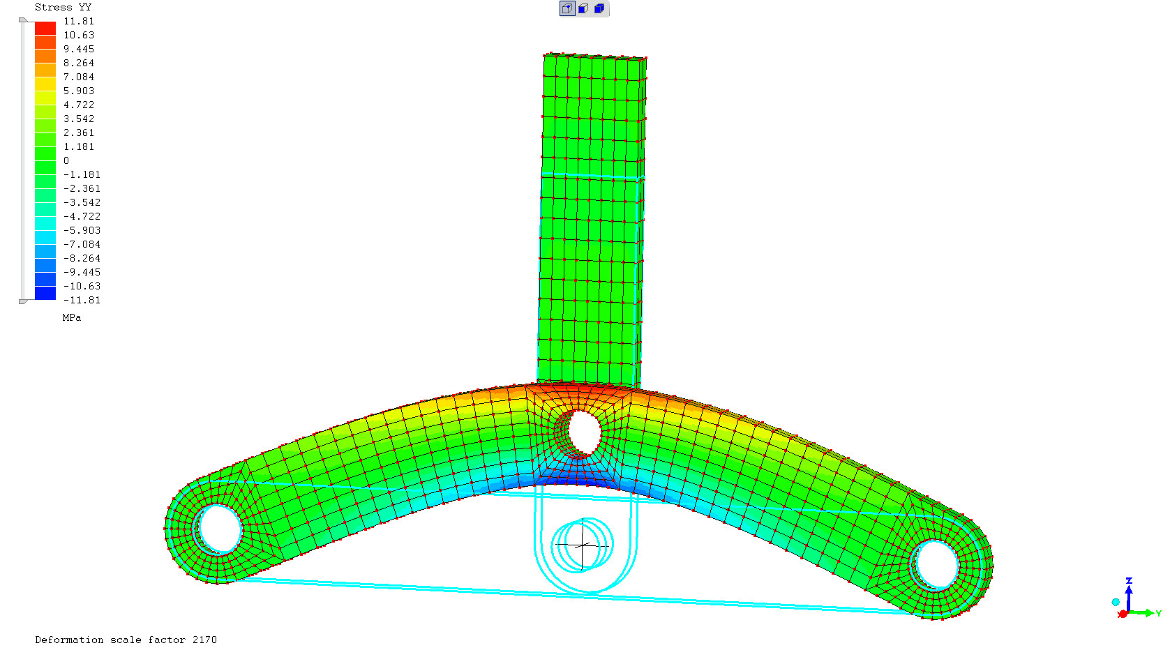

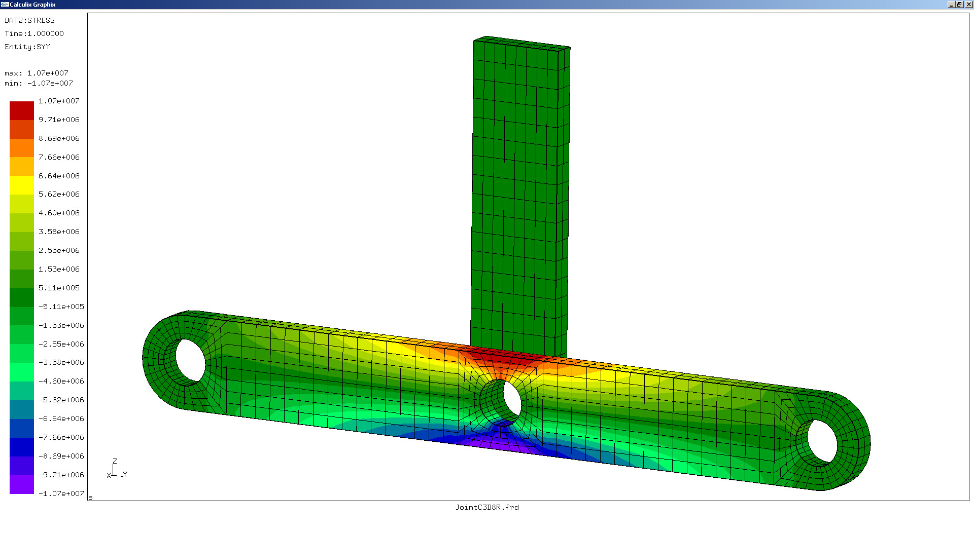

Tetrahedrons C3D10, Hexahedron C3D20-C3D8 and Hexahedron with reduced integration C3D8R.
The results on attached pictures. So is possible to see how C3D8R underestimates the stress YY due to bending moment.
User could be free to choose which element is better relative to the on going study .

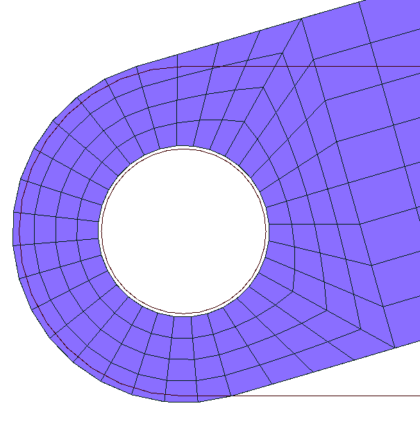

But my focus was how to use DCOUP3D elements to join two cylindrical surfaces. The result is that the axes of the holes are constrained one with the other (same ux, uy, uz) but the two surfaces are free to rotate indipendent. So is like a hinge joint.
Same strategy can be utilized to assign a load or displacements to a node set through the immaterial node of the DCOUP3D element

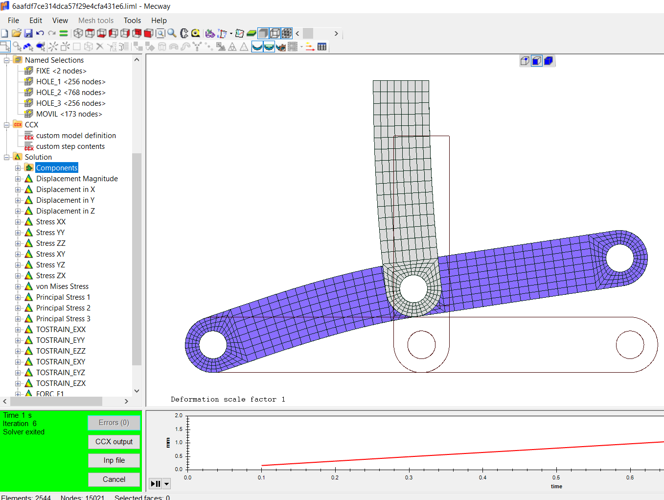

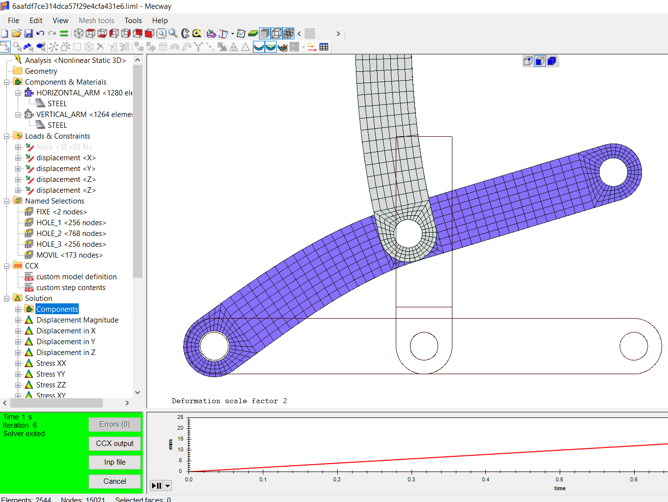

I tried to apply RB to the model but CCX goes in crash. I attach liml file to check.
I you have time check the RB applied on CCX cuxtom model definition.
I tried to apply to ELSET, to considering ROT NODE but dosen't run.
Maybe the problem is in Equation card to tie the two ref points

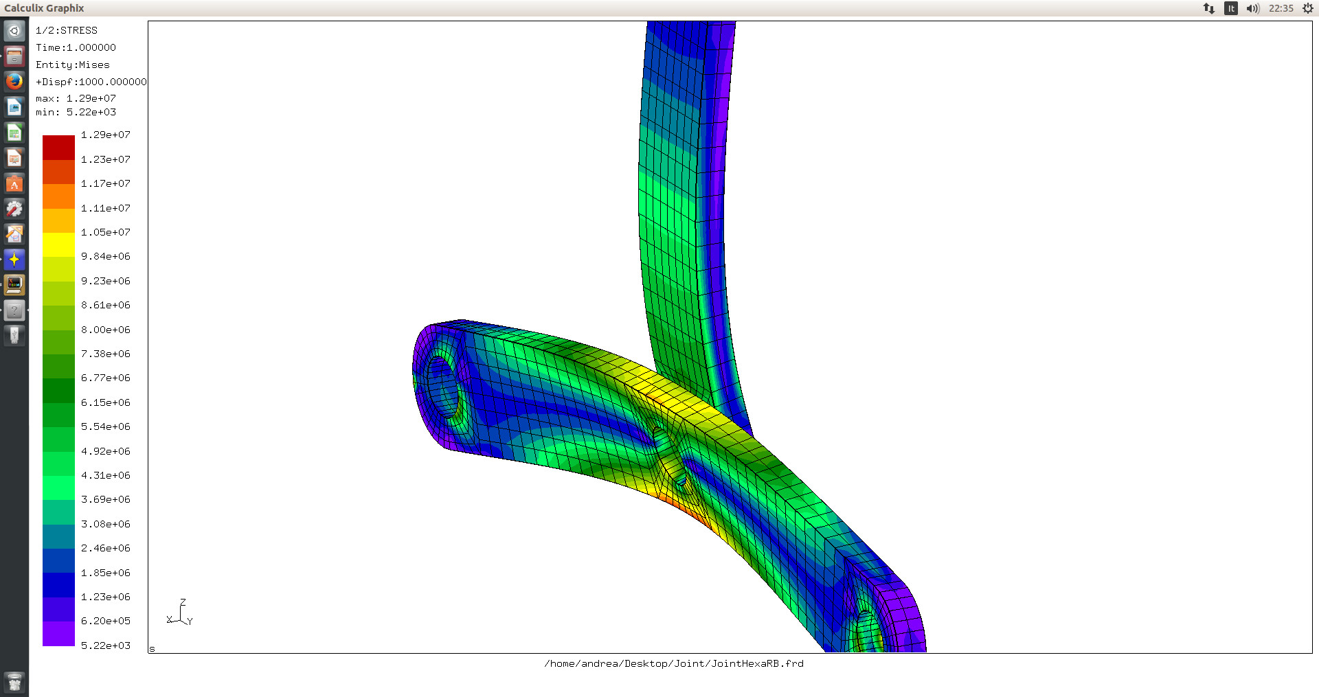

The problem is CCX under Windows because I send the inp file for solving under Linux and the model is correct.
There is difference between displacements and stress relative to the other model (with DCOUP3D).
Soo I will install Oracle VM to try under Linux.

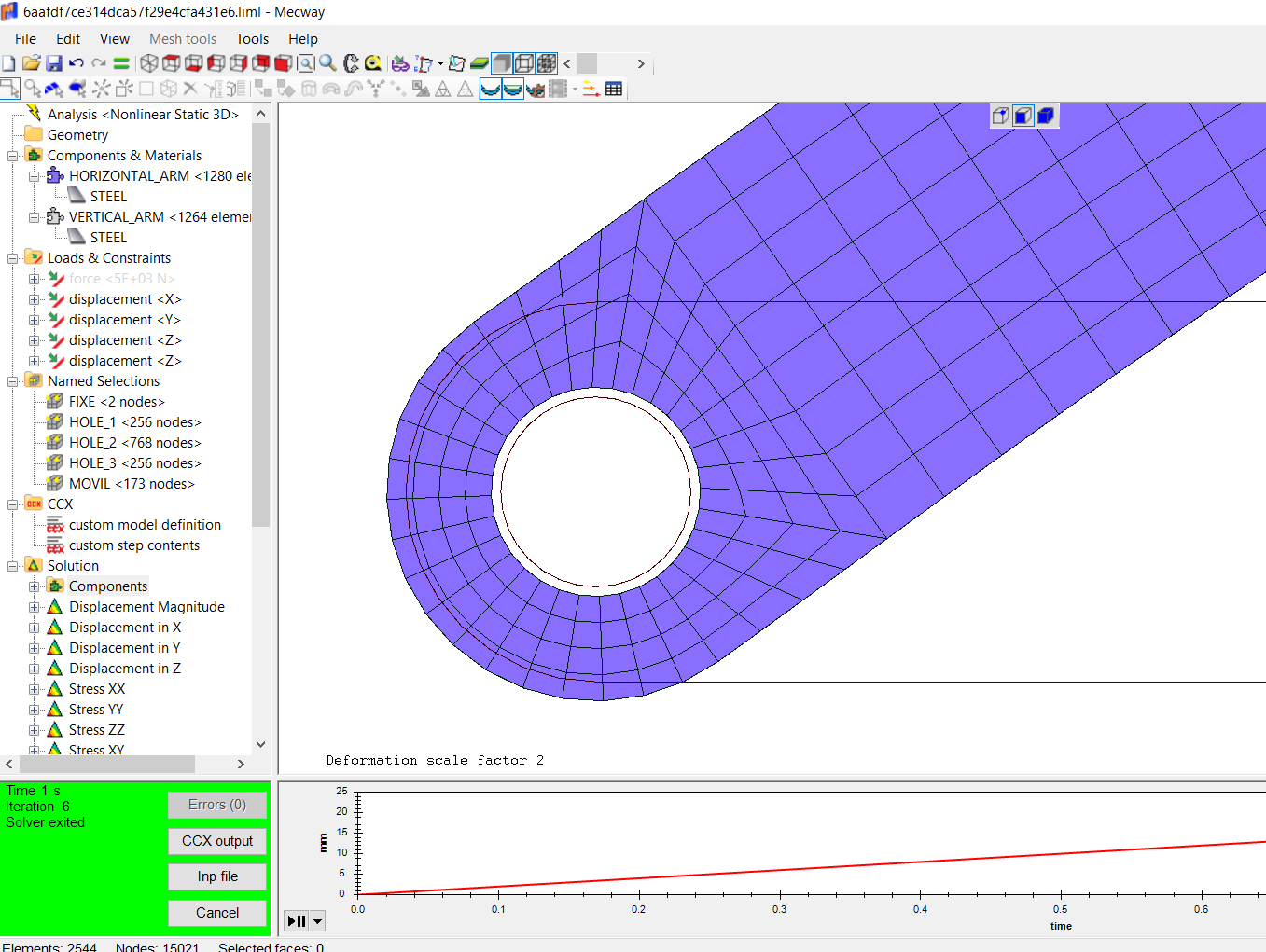

I have changed the vertical arm from the Andrea's model in order to have a perfect simmetric model (otherwise I would have to apply some unreal boundary conditions to restric the lateral deformation as the two arms are not in the same plane)

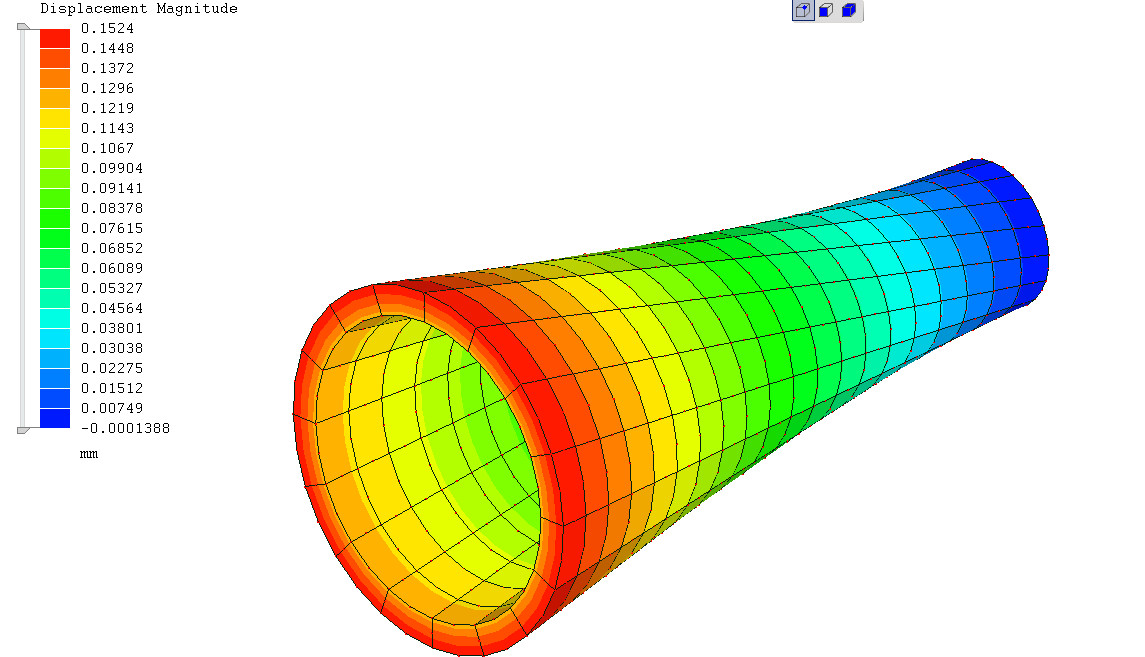

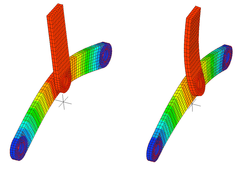

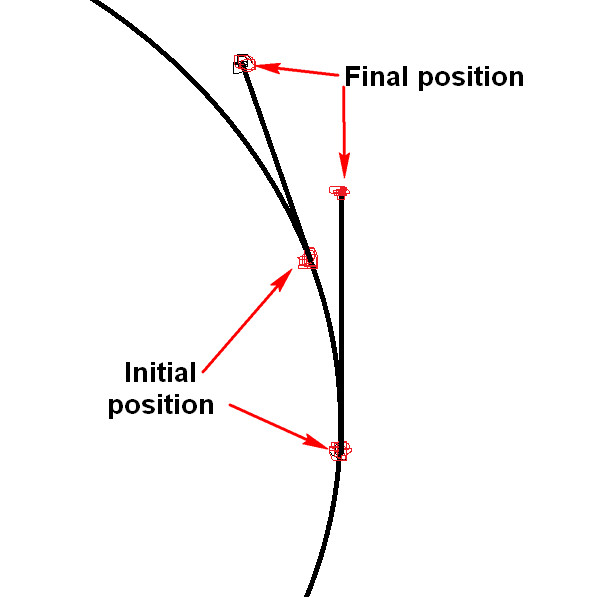

In the real case nodes must move over the circumference. Postprocessor moves the nodes along the tangent. So graphically they appears on circunference of higher diameter. (It's a consequence of the linear analysis -> small displacements)
The worst case is in torsion of a long cylinder or pipe. This effect becomes enormous like a funnel.
I attach the liml file relative to the study with C3D20 elements. You can change elements type in Mecway if you want.

Attention! I had to solve the model under Linux because the combination of *EQUATION and *RIGID BODY cards makes CCX crash. I posted about this problem also into CCX forum. So, as I wrote some time ago, is better to solve under linux above all for buckling analysis. In fact under Win buckling analysis shows vey often strange eigenvalues which are not acceptable. Under Linux the solution is correct
