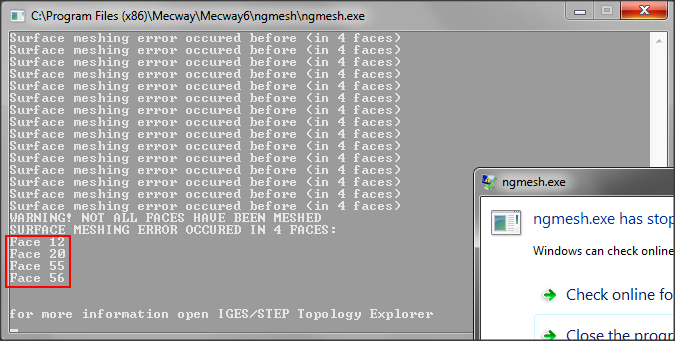

I want to mesh imported STEP surface geometry in Mecway and mesher fails at generating mesh attempt. I've tried a lot of different meshing parameters.
When mesher fails I always see an error, which faces caused an error - marked on attached screenshot. Does anybody know how to get to faces numbers in graphic interface so I can check them before I create an exported STEP file?
1.png 41.4K
  • Guess that not possible to get the output from netgen in Mecway. But you can try to mesh directly with netgen standalone application using the geometry doctor to heal it, or use gmsh or Salome.
  • Thanks for answer, Sergio. I've opened saved STEP file with Solidworks again and then saved it again as STEP file. Now I can mesh under specific parameters. Interesting...
