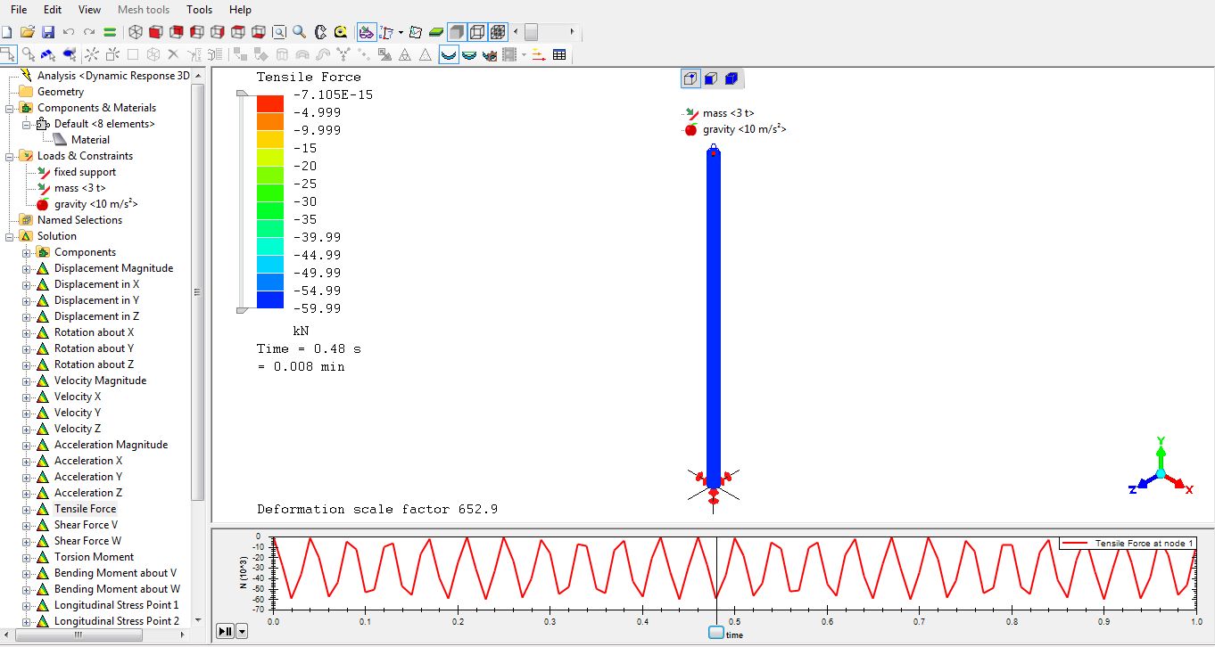

I solved some simple structures with this way and I found some problems in evaluating the envelope of internal forces (or stresses). For example, when I am applying a constant gravity load in the direction of gravity (for example -10m/sec^2 in Y) the forces resulting from the accelerated masses have a variation from zero to double, so it's difficult to evaluate properly the internal forces or stresses.
Bellow is the simplest example of a (zero density) member under a 3 t mass and -10 m/s^2 acceleration (Y), while the horizontal time-dependent accelerations have been excluded (either are present or not the axial force is also doubled) . The correct axial force is 30 KN, but the analysis gives results over time from 0 to 60 KN (from zero to double). Thus, even if this is normal, for more complicated structures and load conditions will be really difficult the proper evaluation of the desired internal forces or stresses.
Sorry about the late reply. The oscillation is because the initial condition is the undeformed state, so it falls down under gravity, then bounces back and oscillates. Mecway doesn't currently allow non-zero initial conditions so you might have to use damping, or a vertical spring-damper element to eliminate that. Or ramp up the gravity initially.
Here's an example with a damper. For linear analysis, it only acts in the vertical direction, so it won't affect horizontal accelerations.
I used trial and error until it damped the oscillation for most of the time steps. There isn't really a proper value since it doesn't represent a real damping effect. It's only valid if none of the time-dependent loading (ie. accelerations) have any components in the vertical direction.
