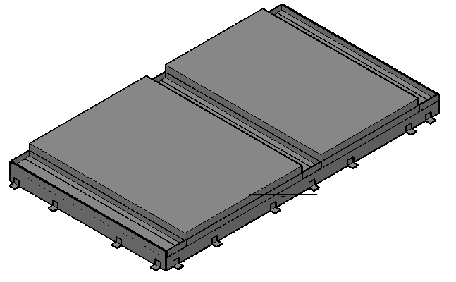

Currently, I'm working on a senior design thesis project that requires the use of a combination of pre-engineered forms and fabricated steel to cast concrete and want to ensure deflections are
/32 of an inch.
What I think i've got covered:
1. My steel forms - i know the thickness, material, connections, etc. I can model this with Mecway
What I can't seem to figure out how to do:
1. Input custom moment criteria for a geometry file (specifically the two shapeless boxes in the middle of the form) - in this assignment those shapeless boxes are prefabricated forms and don't provide much information other than safe working loads and Ixx (7410 in4) and Iyy (39.6 in4).
- Is there a way I can input these properties without getting into the complexity of the forms themselves?
2. Is there a way I can provide a pressure gradient? Specifically start a hydrostatic pressure at 1500 lbs/SF at the bottom of the form and 0 #/SF at the top?
