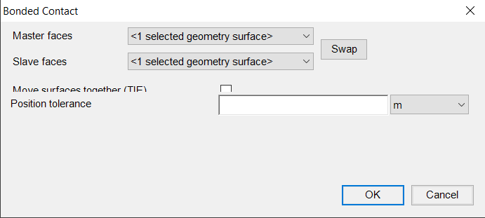

    2) On bonded contact window, there is a glitch in the controls. Also the unit is not taking the user current units (should be mm in this example)

    2) Thanks.

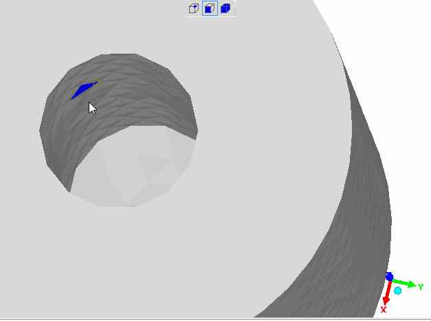

    "Paint select's brush size scales with mouse speed, making it easy to select all the way to sharp edges."
    I'm really struggling with this new behavieur, is dificult to me to make big selections, now the brush is almost a fine brush only. The size scaling appear very rarely in my models ;-(
  • Mecway 6 Beta 2 here
    The main change is the paint selection tool is split into two tools - one for paint selection and one for selecting all the way to the edges of the mesh.
