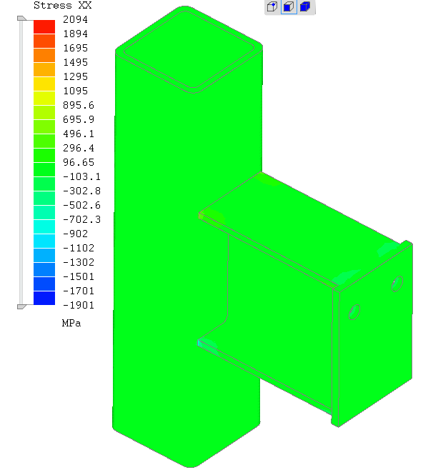

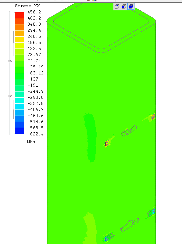

Also if the scale bar had the sliders at top and bottom when ever the min and max were manually entered would be useful, especially when you get an unusual stress concentration like in the attached picture. Note the auto max and min values due to what i assume is an incorrect concentrated stress. Comparing this with the majority of the stress values, it would be beneficial if the sliders were at the top and bottom when either the max and min values are manually entered or when the element with the peek stress was not currently visible. see the amount of stress levels outside of the visible mx and min in image 2

    As for the max/min sliders, I don't quite understand what's wrong with the sliders not being at the top and bottom. Is it that sometimes they're so close together that it's hard/impossible to slide them short distances? In your 2nd image it still looks reasonable. I know that having to cut off a large chunk of the stress range is a common issue and the sliders sometimes end up right next to each other so you can't slide them anymore.

    Yes is mainly the loss of range when there is a peak stress somewhere. I thought it would be useful to have the full slider range, whatever the range you set. Especially if you have hidden parts that have the concentrated peak value.

  • I still don't understand the need for full slider range after setting the max/min. Can you show an example? The example above looks fine without full range, doesn't it?
