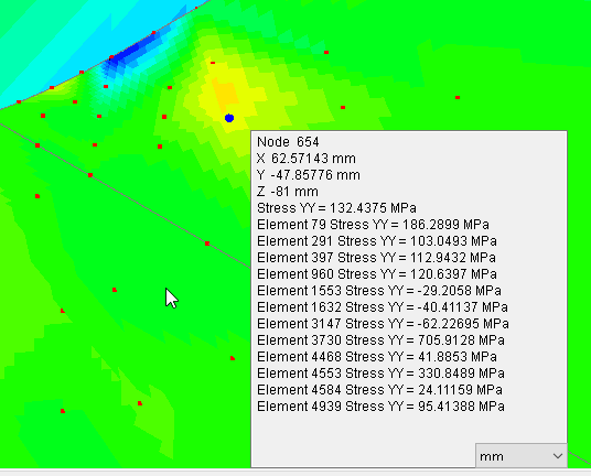

Hi Victor, are the stresses on nodes across components averaged or keeped separated?

Both.
If you select a node you will see the stresses from all the elements attached to the node, And a single node stress value.
I would therefore assume that the the Node stress values are average of all the stresses in the elements attached to the node.

September 2016
edited September 2016
excel check proof:
