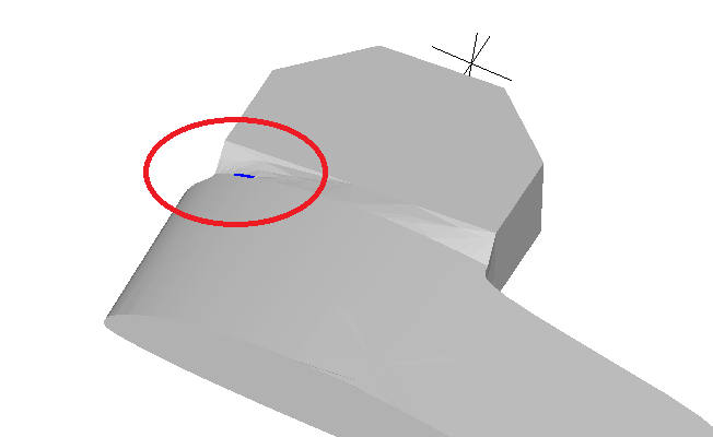

I had a relatively simple part that refuses to mesh. Sometimes with a very small change in geometry it will mesh. I have attached the part showing a geometry that will not mesh. I seem to be flying blind when it comes to where and how the mesh fails. Is there a good way to troubleshoot the mesh failure? Is there a better meshing tool on the market? I seem to spend most of my time fighting meshgen... Mecway works great. Meshgen not so much.
  • In looking at things closer, it appears that the STEP file has some faces that should be edges instead of faces. Not sure why my CAD program is generating those faces. I think they are most likely the problem. Is there a way to edit the faces so that the meshing program is happy?
  • Here is the model cleaned up a bit. Still doesn't mesh. Looking for a way to isolate cause of failure

    1) Look for weird parts on the geometry preview. Your 2nd file here seems to have two surfaces overlapping which you can sometimes see from the random dots shown in the attachment. These usually indicate one surface showing through another because they're at almost the same location.

    4) If surface meshing fails, as it does here, export the same geometry from your CAD program as an STL file, then open it in Mecway and do the same checks described in step 2. I tried this using FreeCAD to convert STEP to STL. The 2nd file shows some non-manifold edges while the 1st file shows this edge/face problem you identified with some triangles flattened into lines. It might be these two different problems with each file.
    5) Download the Netgen application from Sourceforge. Others have had some success with the geometry healing tool in that, or just having it work when the one in Mecway doesn't.
