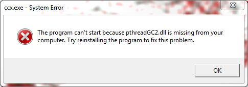

I thought I'd start trying to play around with CalculiX and have hit a bit of a snag. I installed the bConverged version CalculiX_2_10_win_002.zip and then tried to run the PipeClip.liml example. I then get the ccx.exe system error message (picture attached). I reinstalled CalculiX but the same happens.

  • It's because some environment variables aren't set. Either:
    - Use ccx.bat that's installed along with CalculiX, rather than ccx.exe. Beware that with a batch file, if you shut down Mecway while CCX is running, it can continue running silently in the background.
    - Copy those dll files from their locating in the CalculiX installation folder to the same one as ccx.exe
    - Set the environment variable(s) yourself in Windows
    - Use the older 2.8p2

  • Hi Victor,
    I installed the older 2.8p2 and all is working perfectly.
