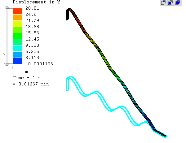

  • A bit of a mystery. Changing to 2D elements, it extends the full 28mm (attached picture and .inp file). I wonder if there's some kind of instability because of compressive hoop stress? To investigate further, I'd revolve the mesh into 3D similar to what CCX does but you'd have more control over it, like a narrower angle which might eliminate any buckling.

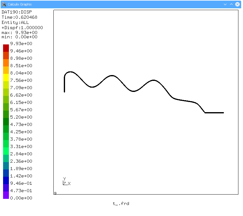

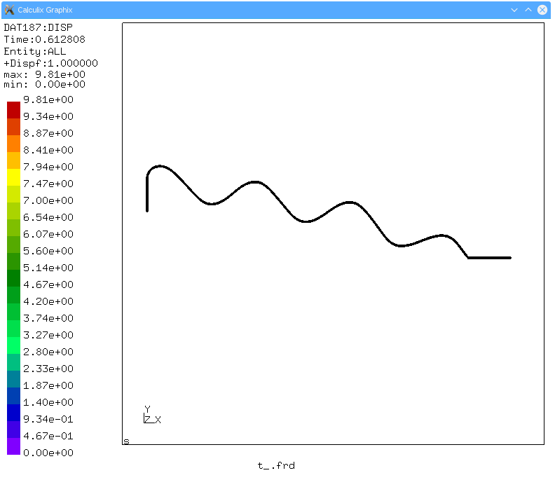

    I also tried to lower the step time to 1e-10 or so, and here are two pictures, something strange is happening at time step 0.62.

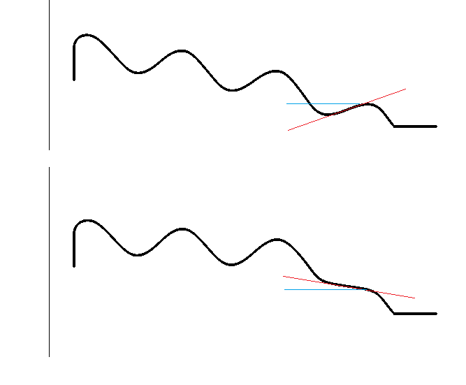

    Still on my pet theory of buckling. Your pictures gave me an idea. That change looks a lot like a toggle mechanism where a straight beam "snaps" through 0 degrees while being constrained from horizontal displacement. This type of buckling is traditionally hard for FEA and you might need to adjust some of the solver settings to accommodate it. If that's really what's happening then it could be important to model it since it would represent an irregular increase in stiffness as each corrugation unfolds one by one.
    I assume it's effectively constrained against radial motion by the material's circumferential stiffness, which is probably the key difference between the axi/cyclic models and the plane strain one. To check this, I added X-displacement constraints to all nodes on my 2D model and it also failed to converge at a similar stage.
