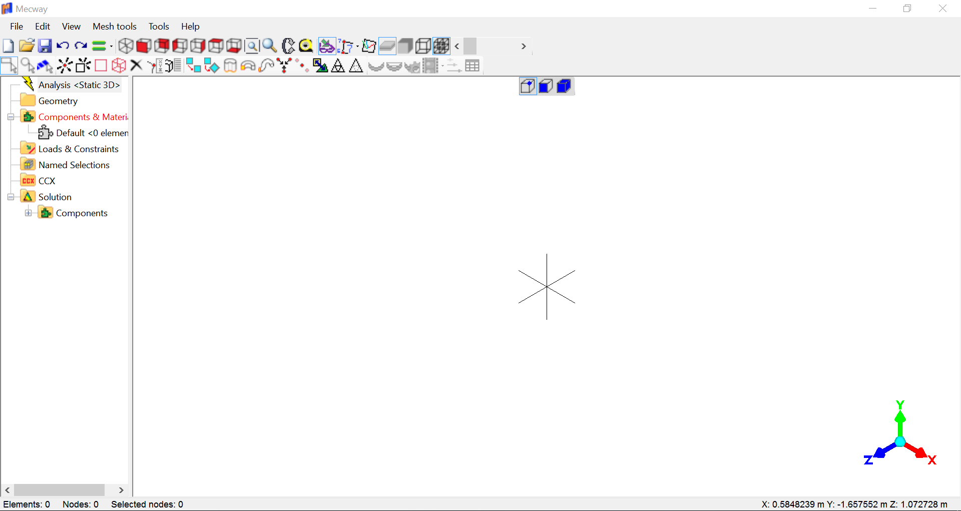

Victor, I just had a chance to try version 5 on my laptop and the icons on top are blurry and so large now and also the triad is large compared to the previous version (the tree is still good). Not sure if I'm the only one. 1080p at 150% scaling on Windows 10 Pro. Thanks

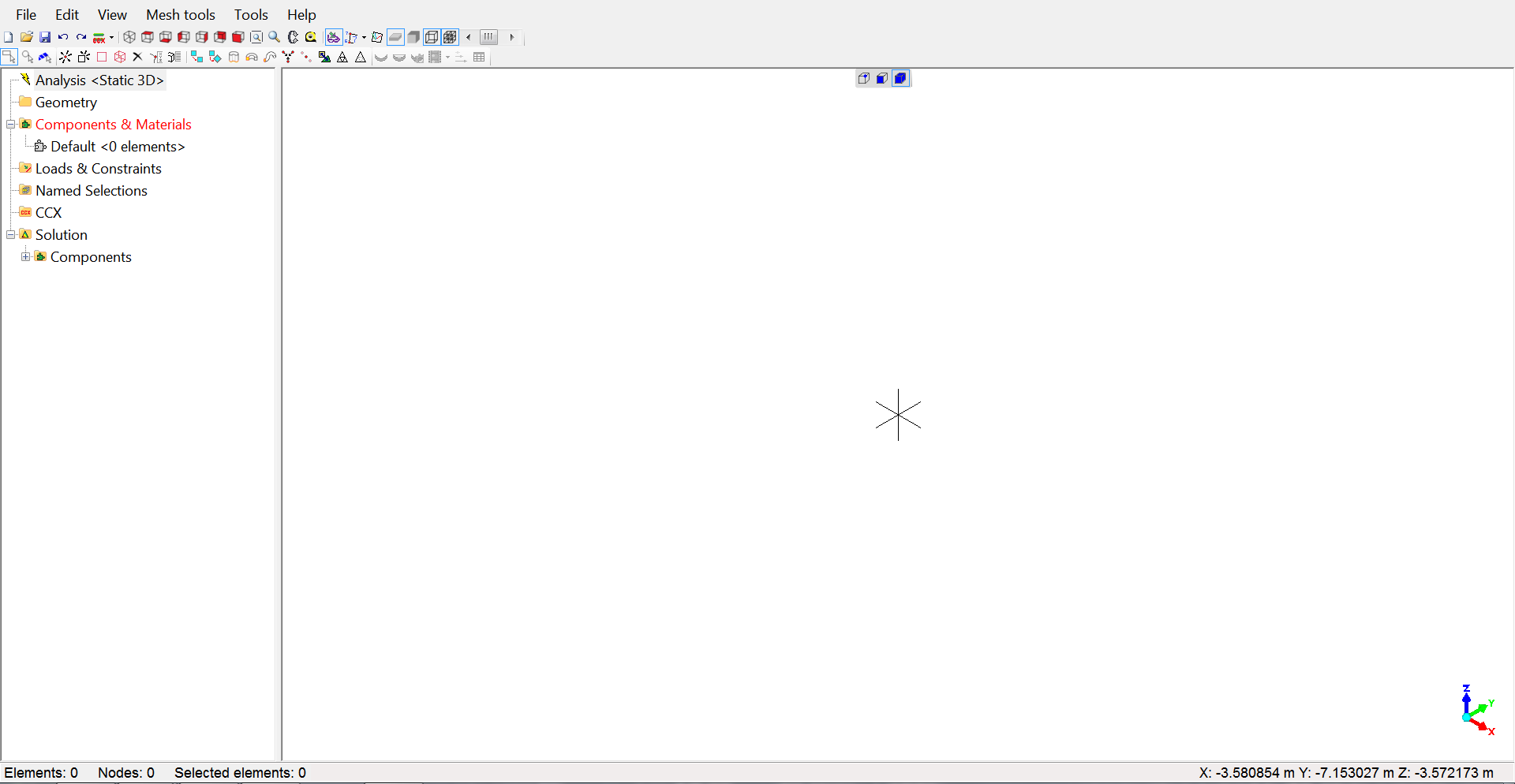

    Victor, setting a custom scaling in Windows to 149% got the icons smaller than what I had in Version 4 (which was a great size) but this is okay for now. Thanks
  • screenshot. hopefully there would be a fix later.
  • Victor, my apologizes: setting a custom scaling in Windows of 149 got the icons the same as what I had in version 4. Thanks.
