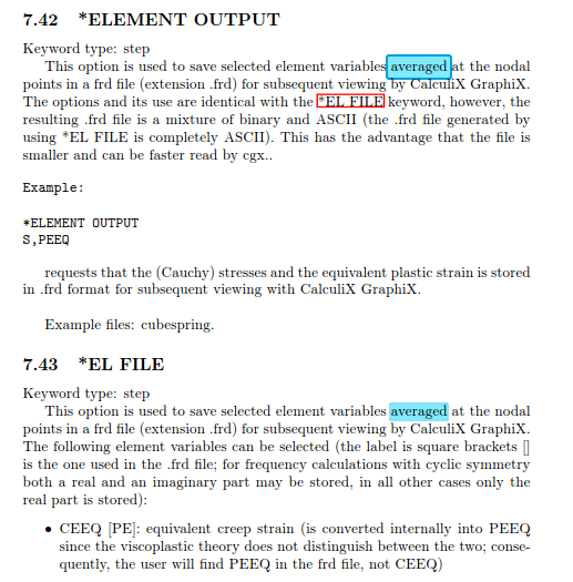

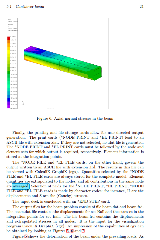

  • As far I remember in CCX results are always averaged, see this screens from the 2.10 documentation:

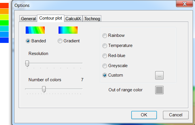

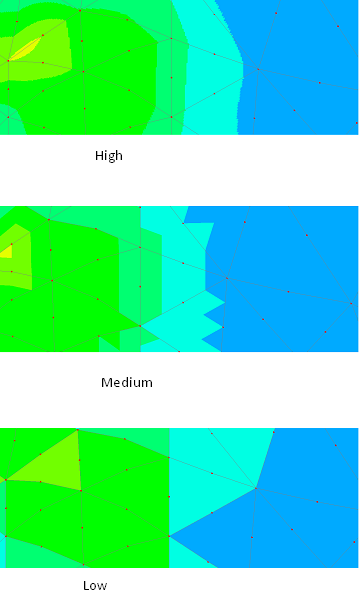

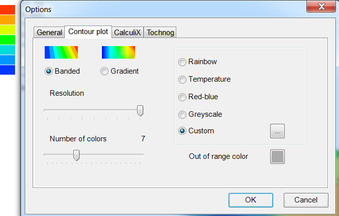

  • The resolution setting in Mecway is related to the resolution of the textures used for displaying the contour plots, not the nodal averaging, which is always on for CCX as Sergio said. The setting is just there to tweak performance because higher resolution is slower and uses more memory.
