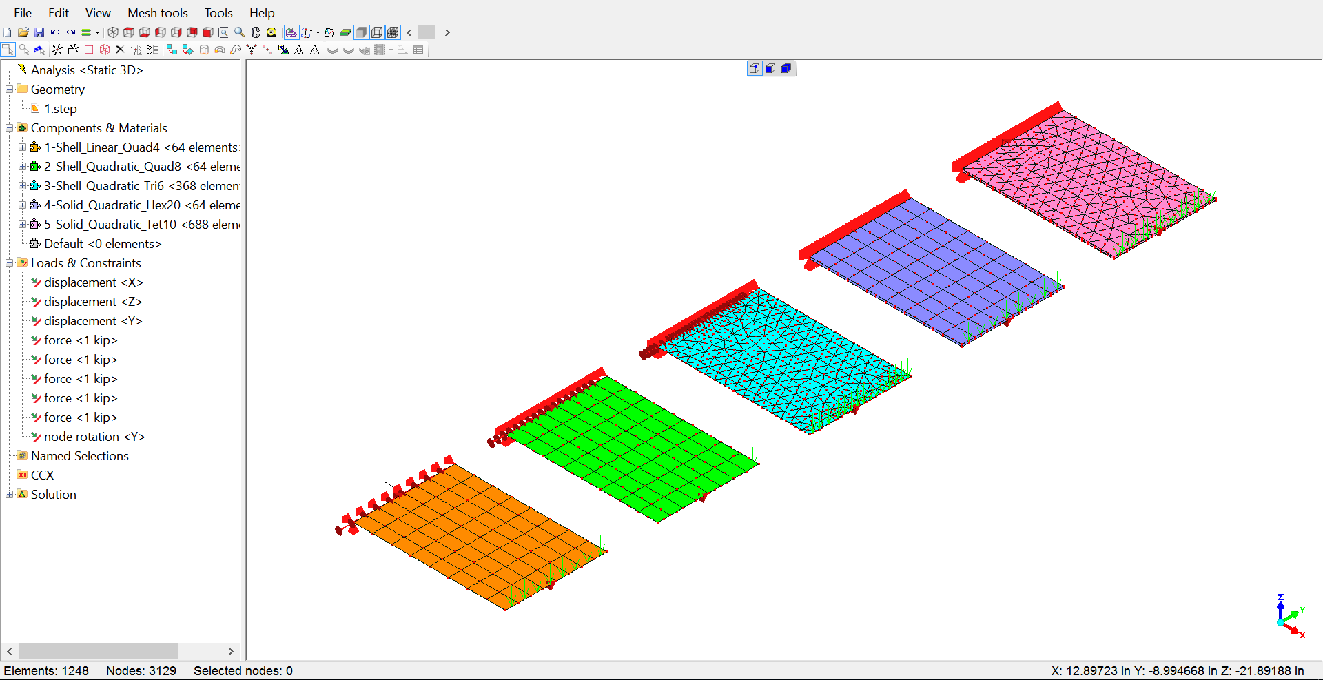

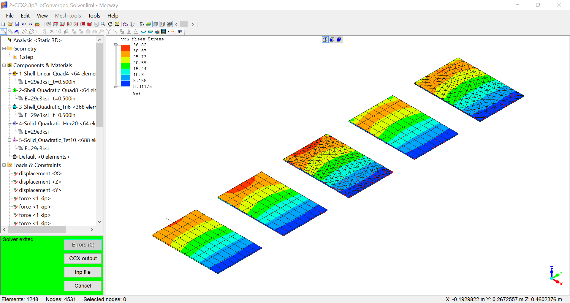

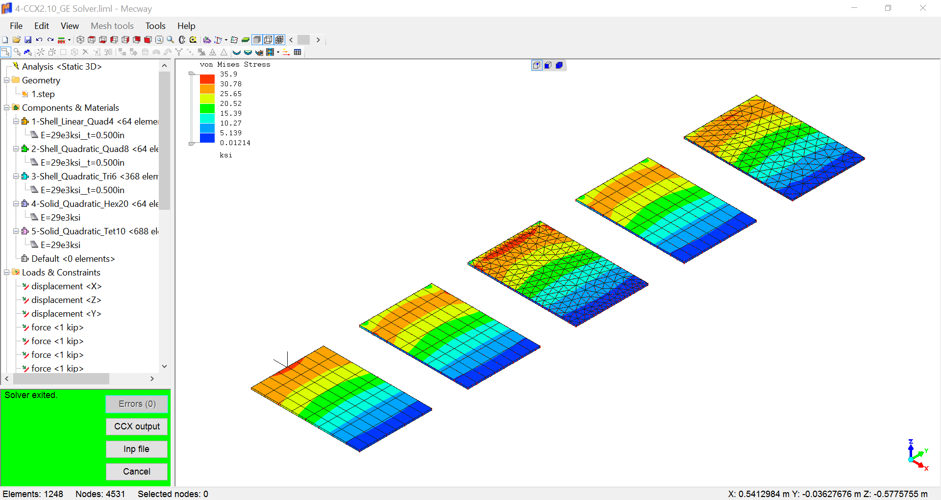

    FYI. I did a test to check out the solvers.
    See attachments for a comparison among several CCX solvers: ccx2.8p2 complied by bConverged, ccx2.10_MT complied by Kwip, and ccx2.10 complied by General Electric (GE).
    A cantilevered flat plate with dimensions of 1/2" x 24"x 36" loaded with 1 kip at the cantilevered end was selected for the test.
    Component 1: Linear Quad Shell Elements (Quad 4)
    Component 2: Quadratic Quad Shell Elements (Quad8)
    Component 3: Quadratic TriShell Elements (Tri6)
    Component 4: Quadratic Hex Solid Elements (Hex20)
    Component 5: Quadratic Tet Solid Elements (Tet10)
    From the results, ccx2.10 version from Kwip and GE has identical results. ccx2.8p2 and ccx2.10 versions had slightly different results for the shell elements.
