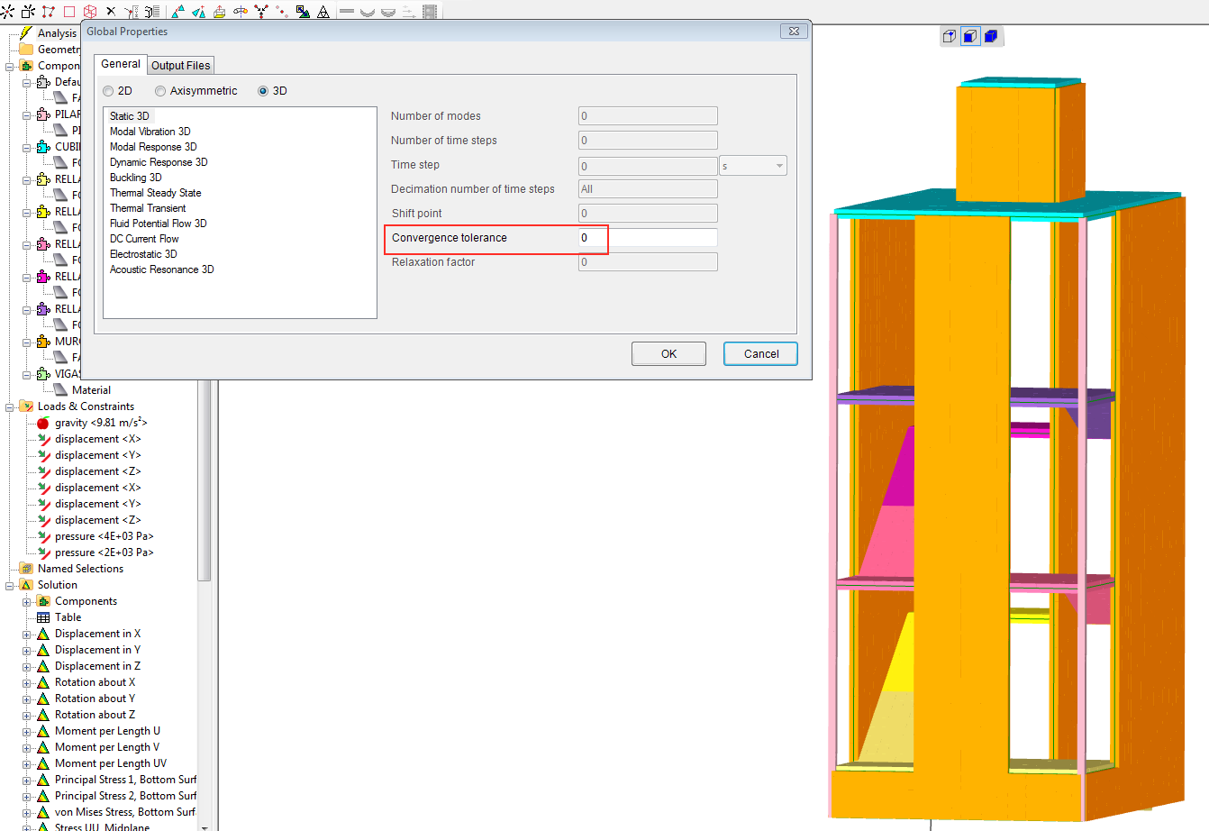

Convergence tolerance
jvrajadell
February 2014
edited February 2014
Is it the solution convergence (Static 3D) ?
80.6K
February 2014
Hello jvrajadell
In Static 3D, the convergence tolerance is only used when it does an iterative solution, which is currently only when compression-only supports are present. Even in that case, the default of 0 really means 10^-11 which is often adequate.
