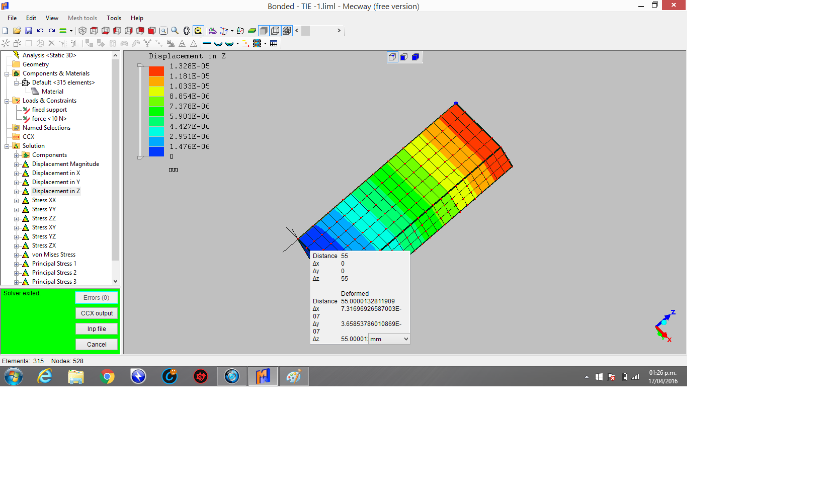

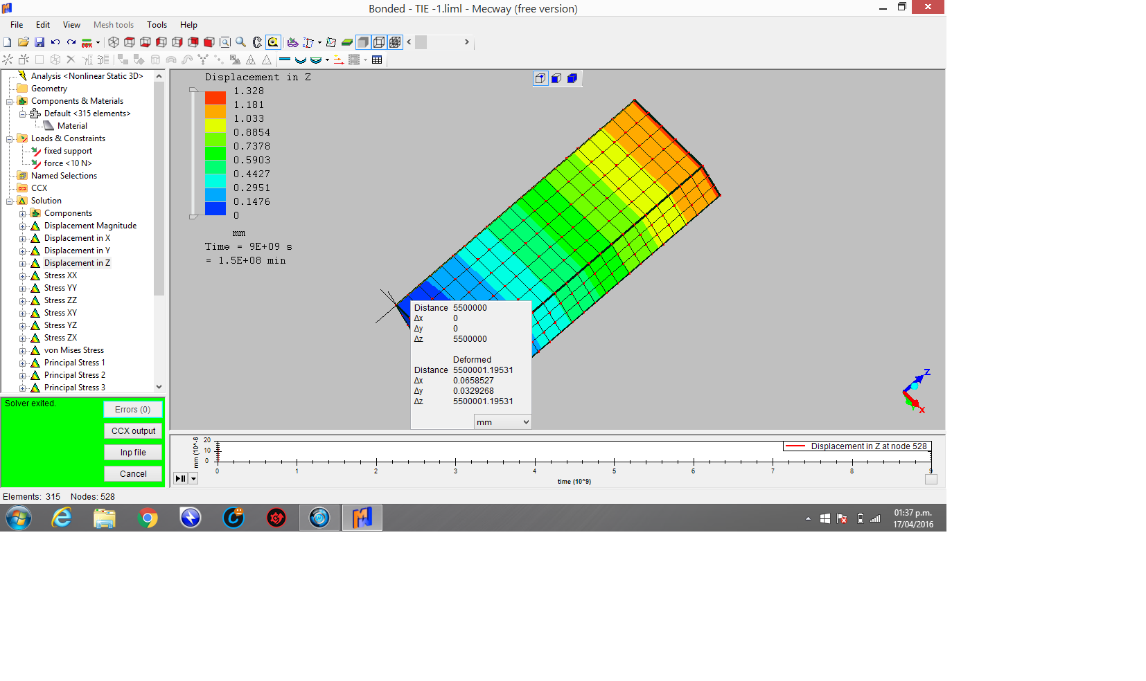

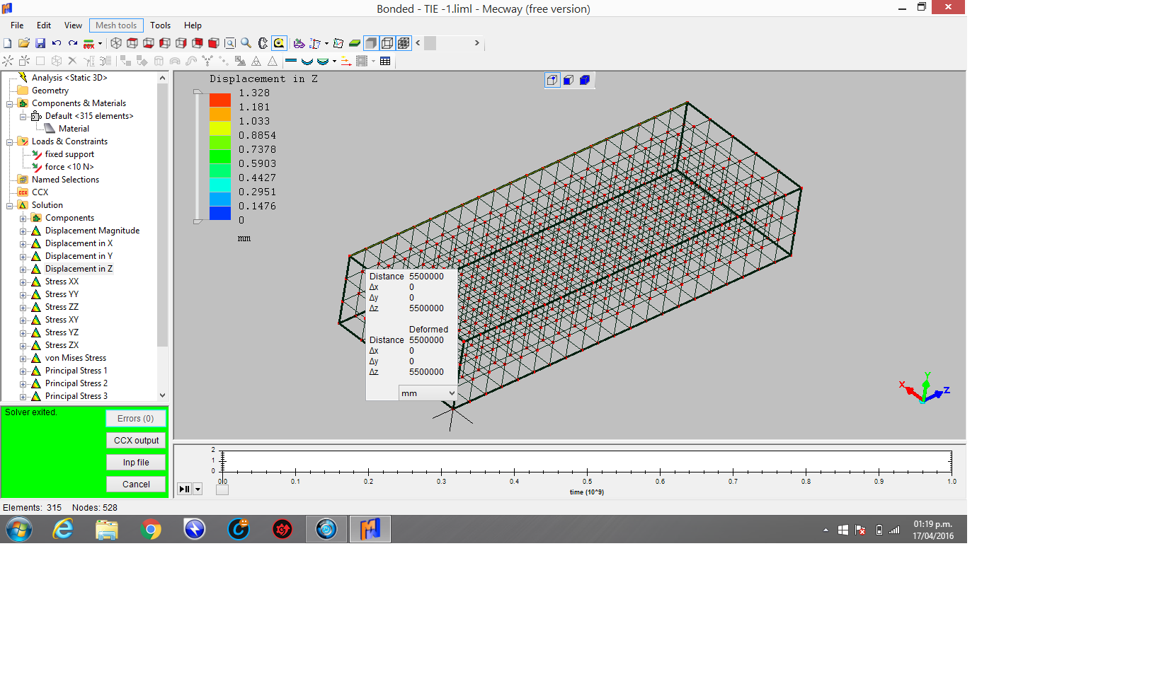

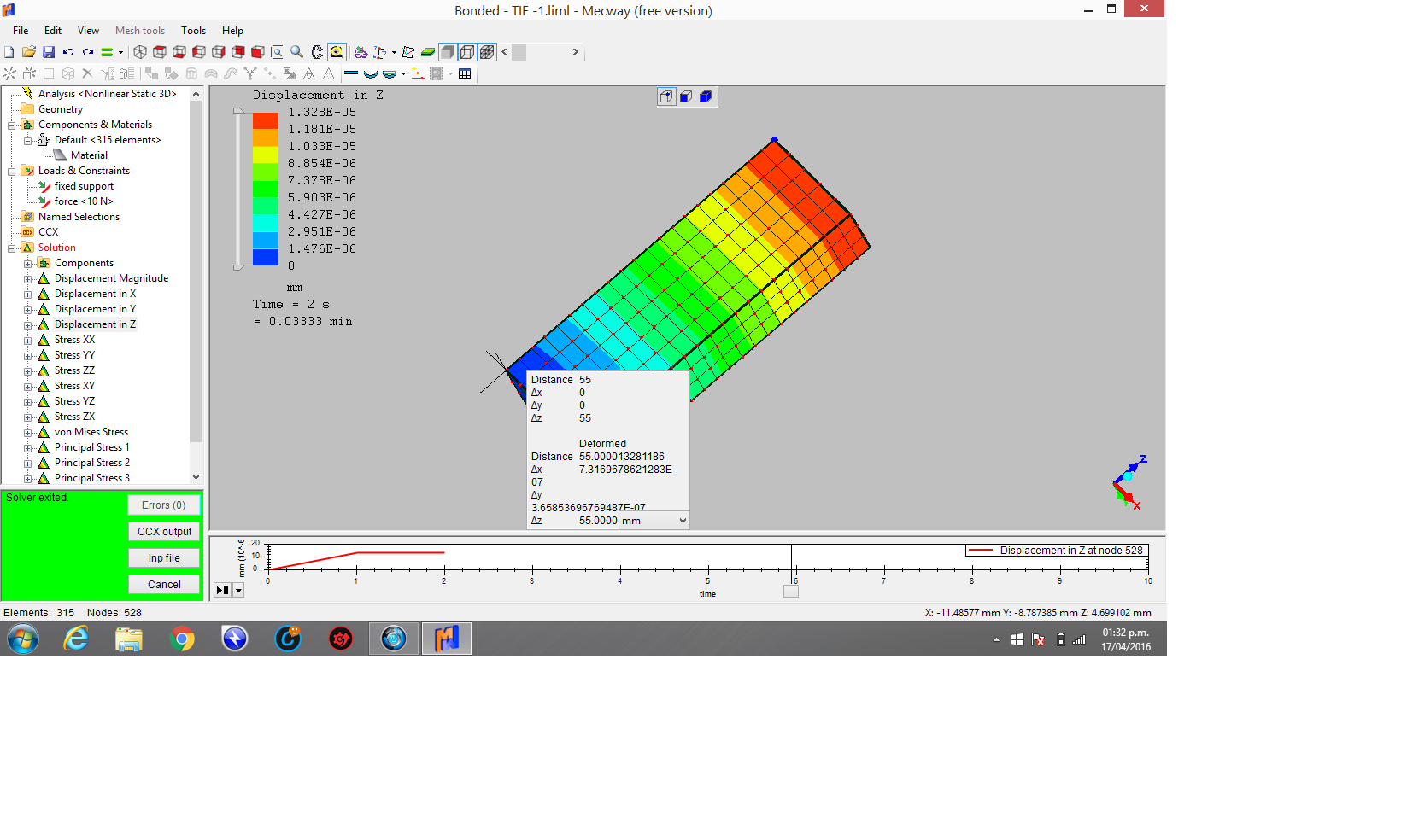

I am a new user of the software and I have a problem, when I make a model in Mecway solved with its solver the solution is ok, but when the same model I process with the solver Calculix linear or nonlinear the model increases in size, for example length model goes from 55 mm to 5500000 mm. I Reinstall the program and Calculix and the problem persists. Any opinion why this happens ?. Sorry for my English.
  • Hello AndresLT. This is a recently discovered bug caused by Mecway incorrectly reading decimal separators for some culture settings. Please either:
    - Change your computer's number format to use decimal points or
    - Install the new version 5 beta from http://mecway.com/download/app/mecway50beta.msi
  • Hello Victor
    Thank you for your answer, yes changing the configuration of the decimal point the problem is solved. My configuration is in Spanish with comma separator. I'll try the version 5 Beta to keep my configuration.
