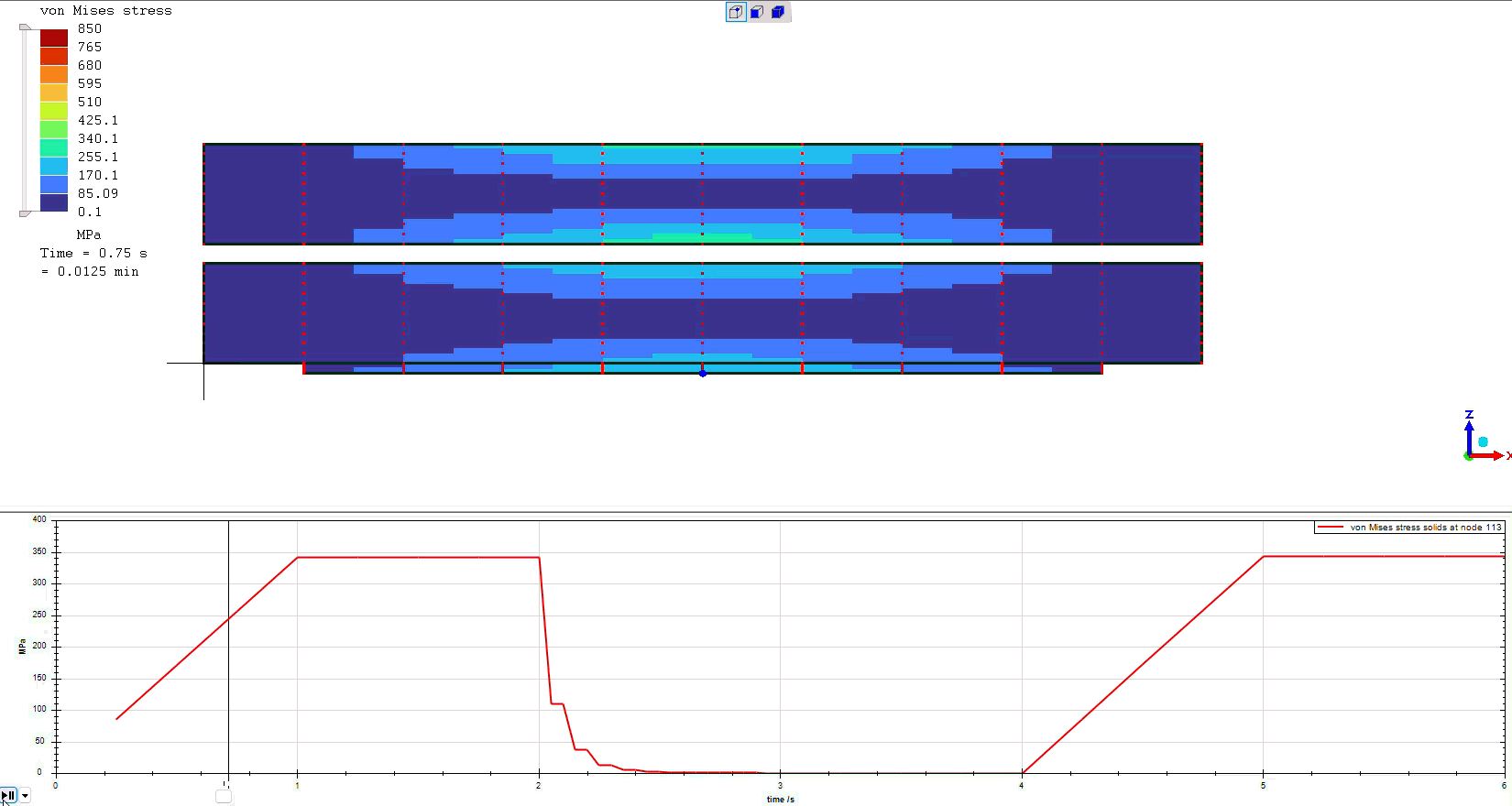

  • This is what I got so far:
    *MODEL CHANGE cannot add anything to the model, unless it was there in the first place. so to add elements or contacts, they must be difined in the the model at first.
    then they can be removed in an initial step and added back again later.
    In my case, using the parameter MECHSTRAINTORESIDUAL turned out to be the better option as far as I can see. It removes strain from a set of elements so they become stress free. Then they do no longer have an effect on the model.
    Im not sure why, but if have to use MECHSTRAINTORESIDUAL repeatedly to remove all stress. It seems that approximately 1/3 of the stress is still there after MECHSTRAINTORESIDUAL.
    In the model are two beams. The top one without reinforcement.
    0-1 sec: Apply load (eg. weight of beam and permanent installations)
    1-2 sec: do nothing - stress in top beam is higher
    2-3 sec: remove strain from reinforcement in 10 steps
    3-4 sec: do nothing - stress in both beams are identical (reinforcement is stress free eg. "not there")
    4-5 sec: increase (double) the load (eg operation loads added to weight)
    5-6 sec: do nothing - stress in reinforcement builds up and the bottom beam shows lower stress levels
    Next step will be to try this on a concrete beam with compression only material and rebars with nonlinear material properties.
