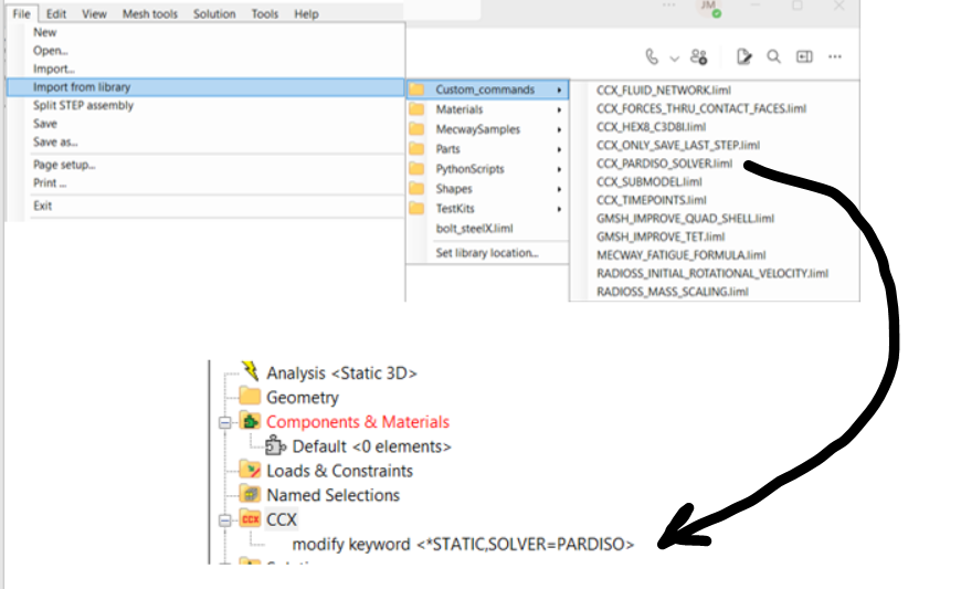

    The build defaults to PASTIX, which works well for us. For those cases where we want to switch to PARDISO, we use the CCX modify keyword command, which we keep in a library for quick access.
