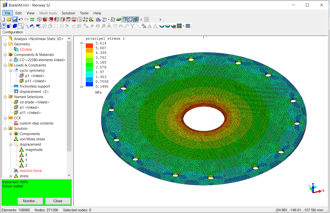

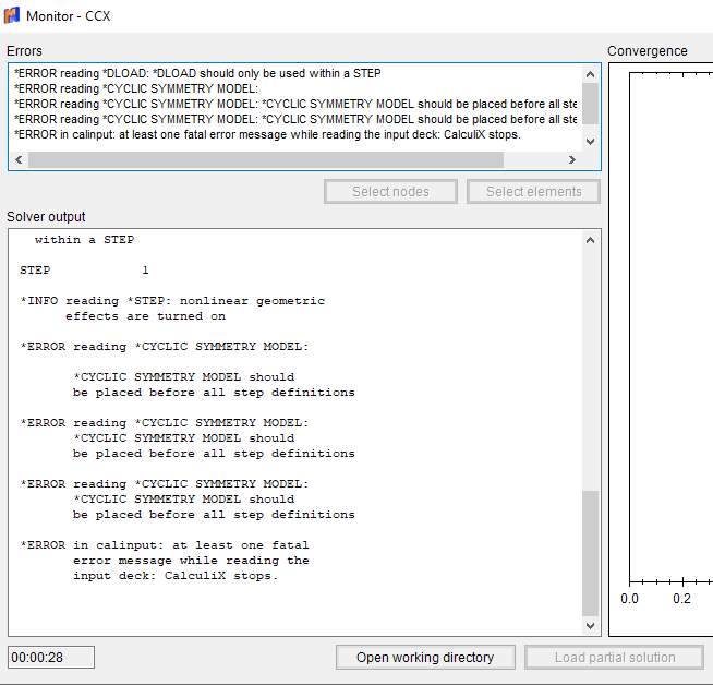

I have a sector model of a disk to be analyzed. I get the following error when I run the case. Can someone help me with this? Thanks
