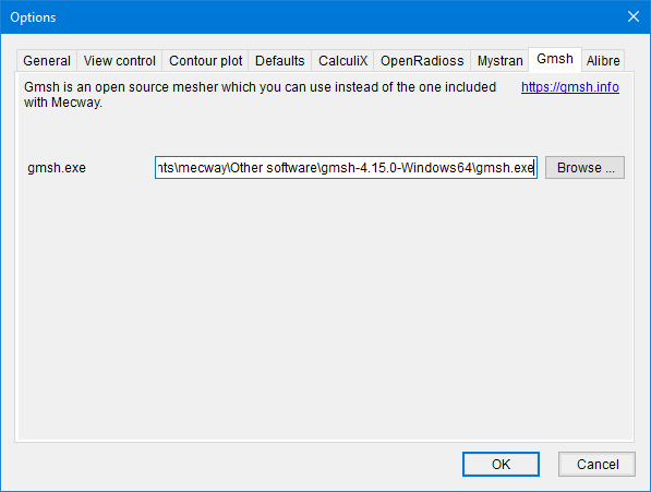

  • Gmsh isn't included with Mecway but you can download it from https://gmsh.info/ and set it up in Mecway using Tools -> Options:
  • How do you set it up? Should I execute the gmsh.exe?
    What is the path in your screenshot? I cannot read the first part of it? Please give me the full path. Thanks
  • See Gmsh for how to install it, then when it's installed, click Browse ... and find gmsh.exe.
    Don't copy the path in my screenshot because it'll be different.
