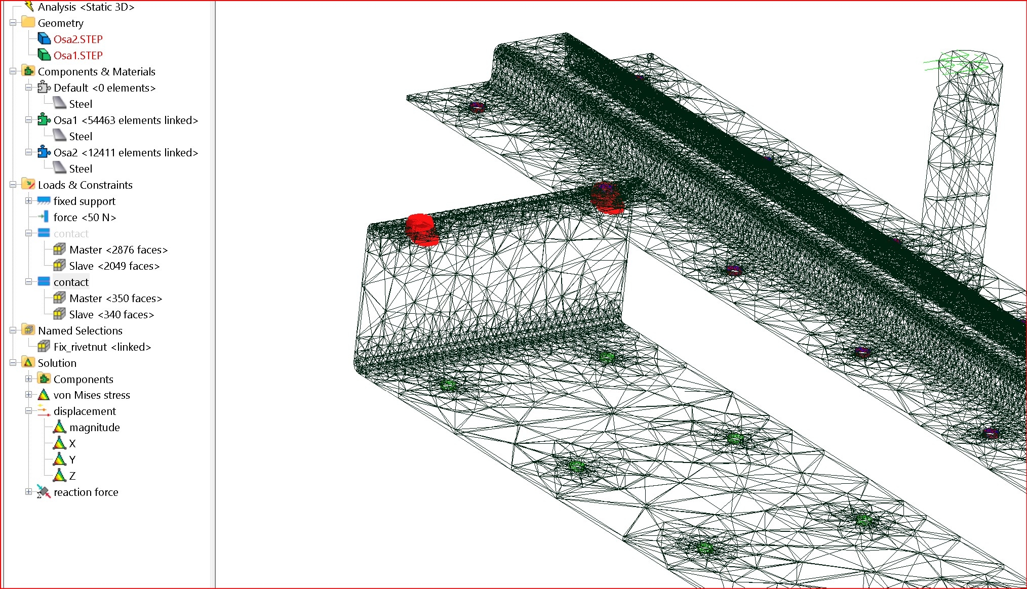

However, a quick look at the stress in the rivets made me a little suspicious of the results -this model suggests the rivets at the ends are under more duress than the ones in the middle- not what I would have guessed -perhaps I have made some incorrect assumptions/setups?
One on the end has the slave faces extending beyond the master faces. I corrected that and it slightly reduced the stress.

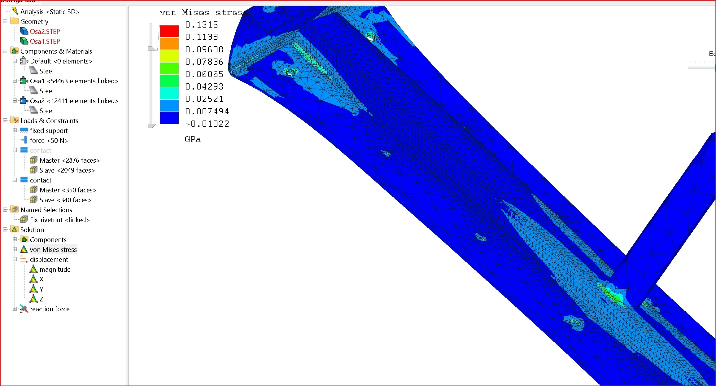

If you look at Stress YY, it shows almost equal positive and negative stress within the same rivet, so you'd have to find an average to compare the overall tension in each rivet. Perhaps for a quick result, take the stress at a node in the center. On the row in tension , that shows 1.4 MPa at the end and 3.6 MPa in the middle on the symmetry plane, so the same order you'd expect.
