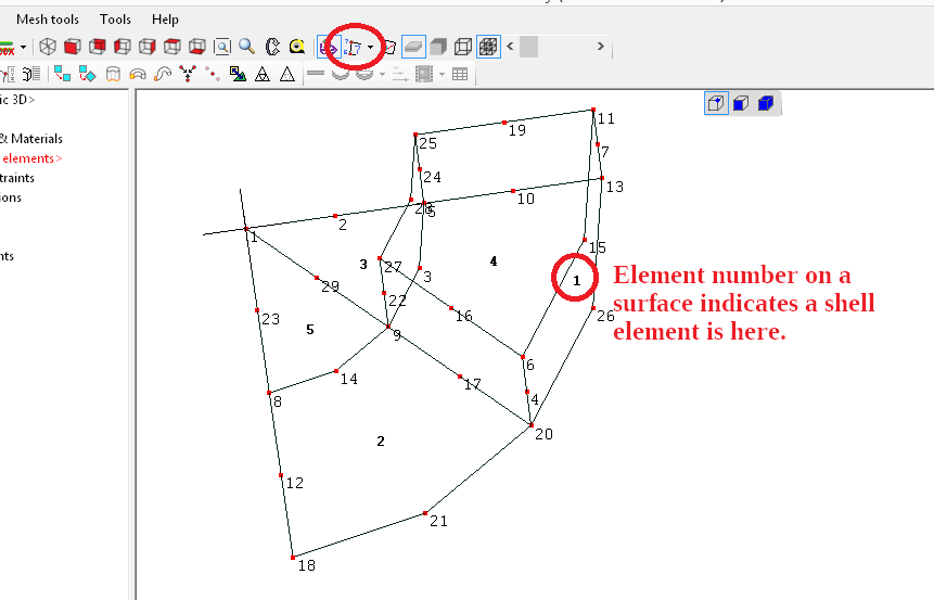

  • One way is to turn on "Show node and element numbers" and look for element numbers on the surfaces. See attachment for how it will appear.
    Alternatively, if the mesh is small enough, use Mesh tools -> Node/element list -> Elements tab and look for tri/quad shapes in the list.
    To select them for deleting, you can:
    Change to Select faces mode
    Edit -> Select all. This selects only the external faces
    Change to Select nodes mode
    Change to Select elements mode
    Now only the shell elements should be selected, as long as there aren't any solid elements with all their faces on the exterior.
    This method would be helpful for discovering them too.
