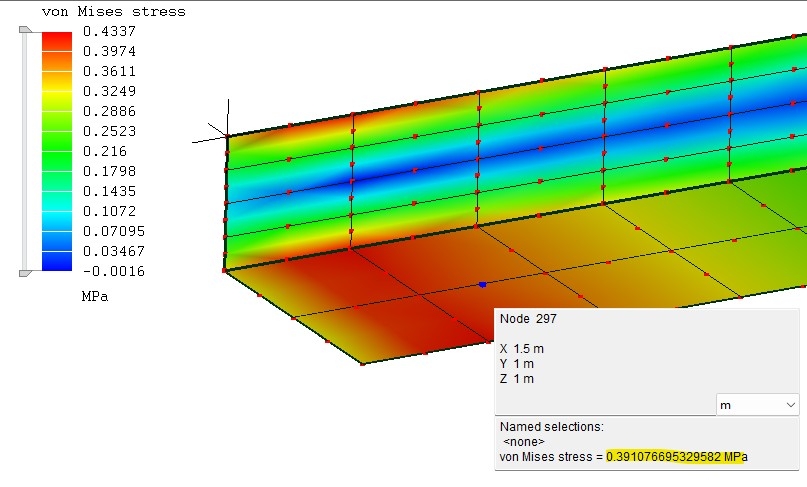

-Is there any button or feature in Mecway that allows you to obtain the stress at multiple nodes at the same time like the feature query in Prepomax ?
- Is it possible to round the units to 3 decimals ? the standard for the software is 15. (very strange)
Thank You
  • Maybe try selecting the (nodes, faces, or elements) of interest while in model view then save them as a Named Selection. After the solve completes, your [Name] will be available to the Solution functions. Particularly useful is the solution Table, where you will be able to see Solution parameters for your [Name] tabulated all together.
    Don't know about Mecway numerical formatting. Often I've exported to Excel for aggregation and changed it there.
