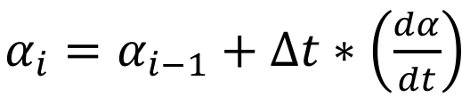

After that, a could be found using:

    Regarding the second equation I don’t understand the reason for that linearization of the Alpha curve.
    If you can get the exact solution of the ODE ¿why do you want to build the curve with a linear approximation?.
  • I looked into the API and I think it will be possible to do, I didn't think about this one.
    Disla, generally temperature is very unevenly distributed so each node needs its own calculation. The linearization is simple enough and gives precise results, it allows to change the model easily too (just change the equation for da/dt).
