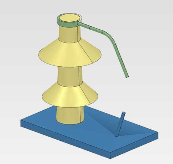

The attached step file only open partially.
  • It seems to have 4 parts but not in an assembly. Maybe you could turn it into an assembly using CAD then either open it directly if that works, or use File -> Split STEP assembly.
    In the next version (29), the Split STEP assembly tool will be able to pull out the 4 parts so you can import them, or it might be able to read them all directly.
