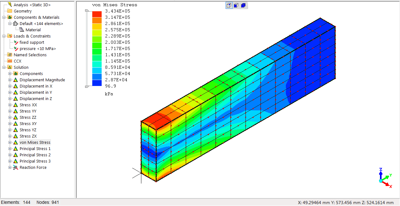

  • Thanks kwip. This is a great resource. I can confirm that ccx_2.9_MT.exe solves the problem of
    "*ERROR in openfile: could not open file XXXXXX.dat"
    which happens with the CalculiXforWin 2.9 on SourceForge.net when run from within Mecway. It's also more convenient to have a single statically linked binary instead of multiple files.

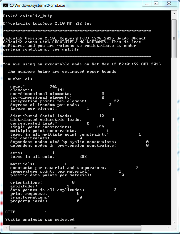

  • hi Kwip,
    thank you for kindly build and provide CCX 2.10 for 32bit Windows. i has been tested for simple case and seem working properly using command prompt.
    but still has issue when integrated with Mecway, error message shown it can not produce *.dat result files.
    best greetings,

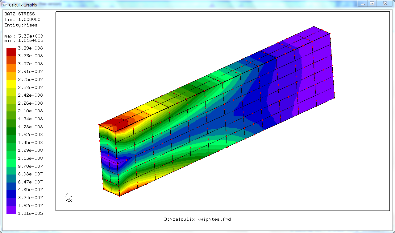

  • Hello to All,
    best compliments to kwip for his great ccx_2.10_MT version. I am facing the same issue as rhoka and Sergio rolling back from windows 10 to windows 7. Everything worked fine on windows 10; this was the only thing that worked fine on that OS on my pc. Maybe kwip the Great compiled his impressive executable on windows 10. BTW everything works great from command prompt.
    Best greetings,
    Stefano
  • edited March 2016
    In my opinion we should keep 2.8 from bConverged for production and the rest only form very special and command line tasks. This will start to look like Linux with their different versions of kernel (CCX) and GUI(Mecway), but in this case there is only one person supporting so maybe we can help him waiting for an "official" release.
