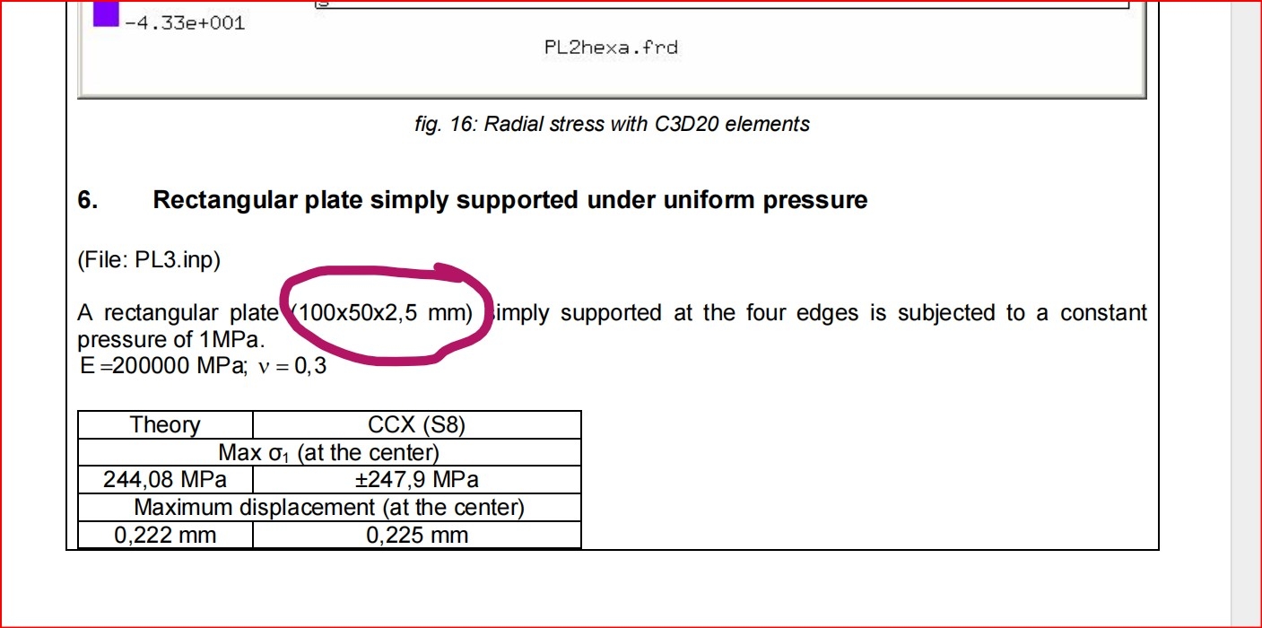

  • I have stumbled across an excellent collection of bench marks generated by Andrea Starnini - see screen shoot attached. I have really enjoyed going thru some of these examples and wonder if other documents like this are available?
    Having work thru many and arrived at the same answers there is one where I think there is a possible type - see attached. I think it may be a 100x50x25 mm plate -not 100x50x2.5. It would also tie in with the analytical solution I found
    Be good t know if this is a typo or if I'm really doing something wrong!
  • That is not a good reference for comparision unless the thickness is very very small so bending stress doesn't have any role.
    If you want to test it you better compare using some Catenary example.
  • Understood, I was using solid elements for that one. I just saw the example and couldn't help but give it a try!
    Thanks for pointing it out though
