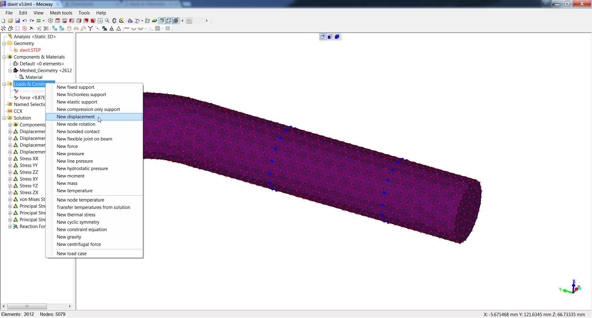

I got the free version of Mecway ( which , by the way i think it's a very nice software for new comers to FEA, especially because it lets users apply forces and supports on directly selected faces ) and modeled the davit arm as best i could ( i attached here the files) and i have a few questions because i think i am doing something wrong :
1 ) I wanted to model the brackets that hold the arm but i could only put fixed supports by choosing the faces and not the nodes ( when i put a fixed support on a node i get an error about the node not being on a beam element). How can i chose a node to make it a fixed support ?

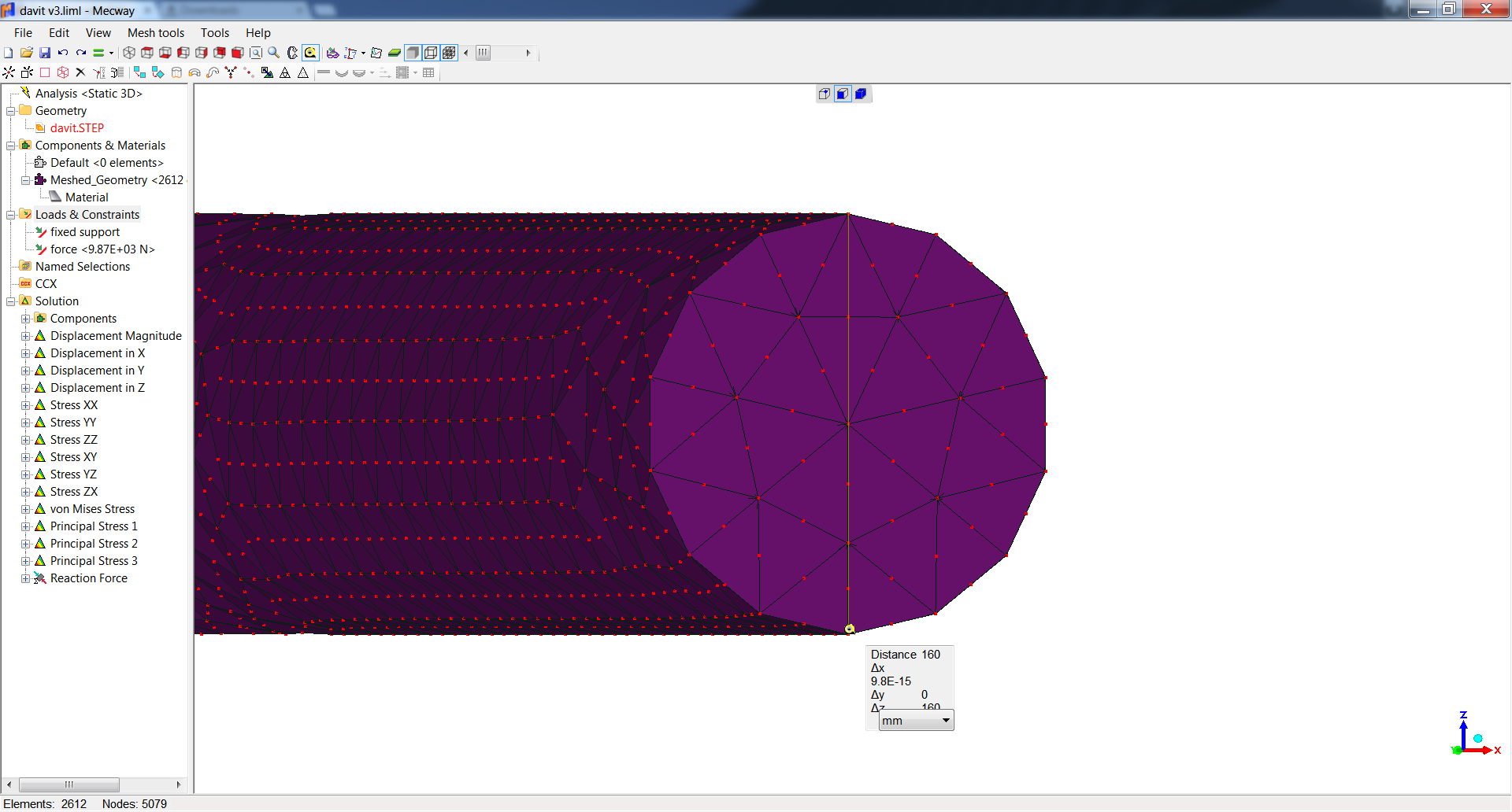

I see a few possible problems with your model. First, the model doesn't match the provided data. The modeled diameter of the davit arm was 160 mm instead of 80 mm (see attachment). Also, it's best to use quadratic tetrahedral element (TET10) vs. linear tetrahedral element (TET4) for stresses calculation. There are a few papers on this but here is one (http://www.designspace.com/staticassets/ANSYS/staticassets/resourcelibrary/confpaper/2004-Int-ANSYS-Conf-9.PDF).
As for modeling the fix support, there are a few ways. I would also create the surfaces where the davit arm support located and then select those surfaces as your fix supports instead of fixing the whole area as you did but the results wouldn't be much different unless you use contacts to simulate the motions to your davit arm support (the two bracklets). Another way is by manually selecting nodes and restraining them (displacements) where the davit arm support located creating a coupling to resist the motion, but due to the meshing, you may not be able to select them nicely (see attachment).

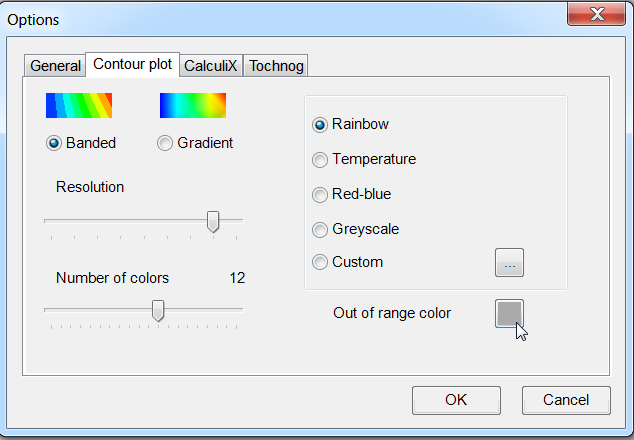

I would run a coarser mesh first to obtain initial solutions (also to save some time to have an overview of the solution and identify possible errors). I then review the stress contours by setting the user-defined upper/max limit for von Mises to an allowable or acceptable von Mises stress (say 0.67 x material yield or 1.5 safety factor against yield). Areas in black (default. you can change this to gray or any other color under Tool --> Option --> Contour plot --> Out of Range) exceed the user-defined upper/max limit. I would focus more in that areas. Then, I run finer mesh to obtain the solutions. If the result differences are within say 5%, the previous mesh (coarser) would be adequate.

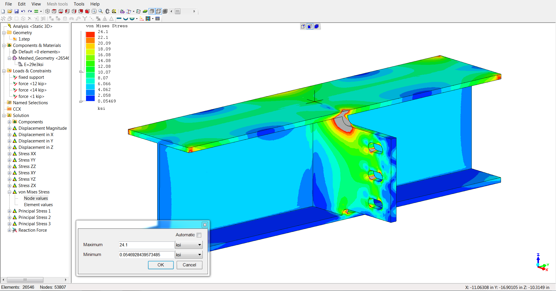

Victor, is there any chance in near future for an additional option for displaying in MECWAY results the element stress at Gauss points? I think this will be a very useful information regarding evaluating the magnitude of any local/nodal stresses but also the quality of mesh.
