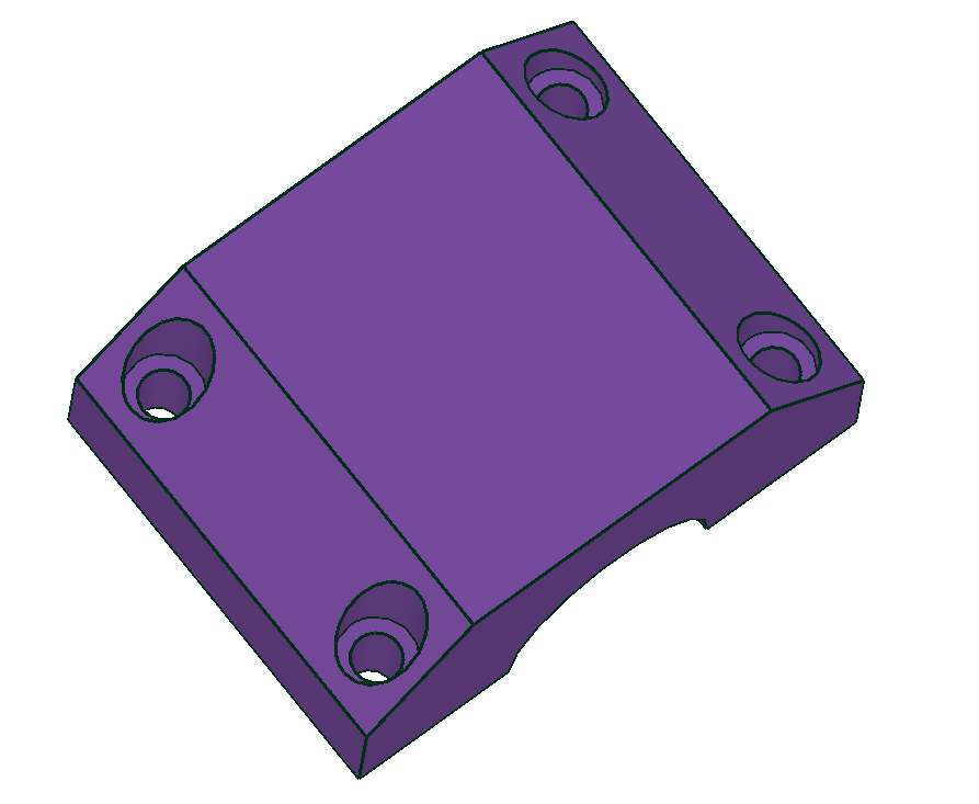

I have a clamp block. The hole (highlighted in the image) touches the surface of a component. The component can take a max of 5Kn force in this area.
Ultimately I want to work out the torque to apply to the 4 bolts to hold this thing down. But a start would be to figure out the force on the bolt holes to apply that 5Kn max to the component.

- is the 5kN target a radial clamping force for torque resistance or something else?
- what are the clamp and clamped part materials?

The 5Kn comes from the spec sheet for the component it's clamping. It's a little vague the spec sheet, it says 'static clamping force >5Kn'. So to play it safe I wanted to use that as a max and go from there.
The clamped component I'm not 100% sure on the material but it'll be a hardened steel I'd assume (it's a cnc spindle)

Just curiosity, what is the purpose of this device?. It does not appear to be used to attach anything other than itself to a tube.
Normally one of the halves is prepared to be fixed but in this case it does not appear to have any rail or base for attachment like in the example.
