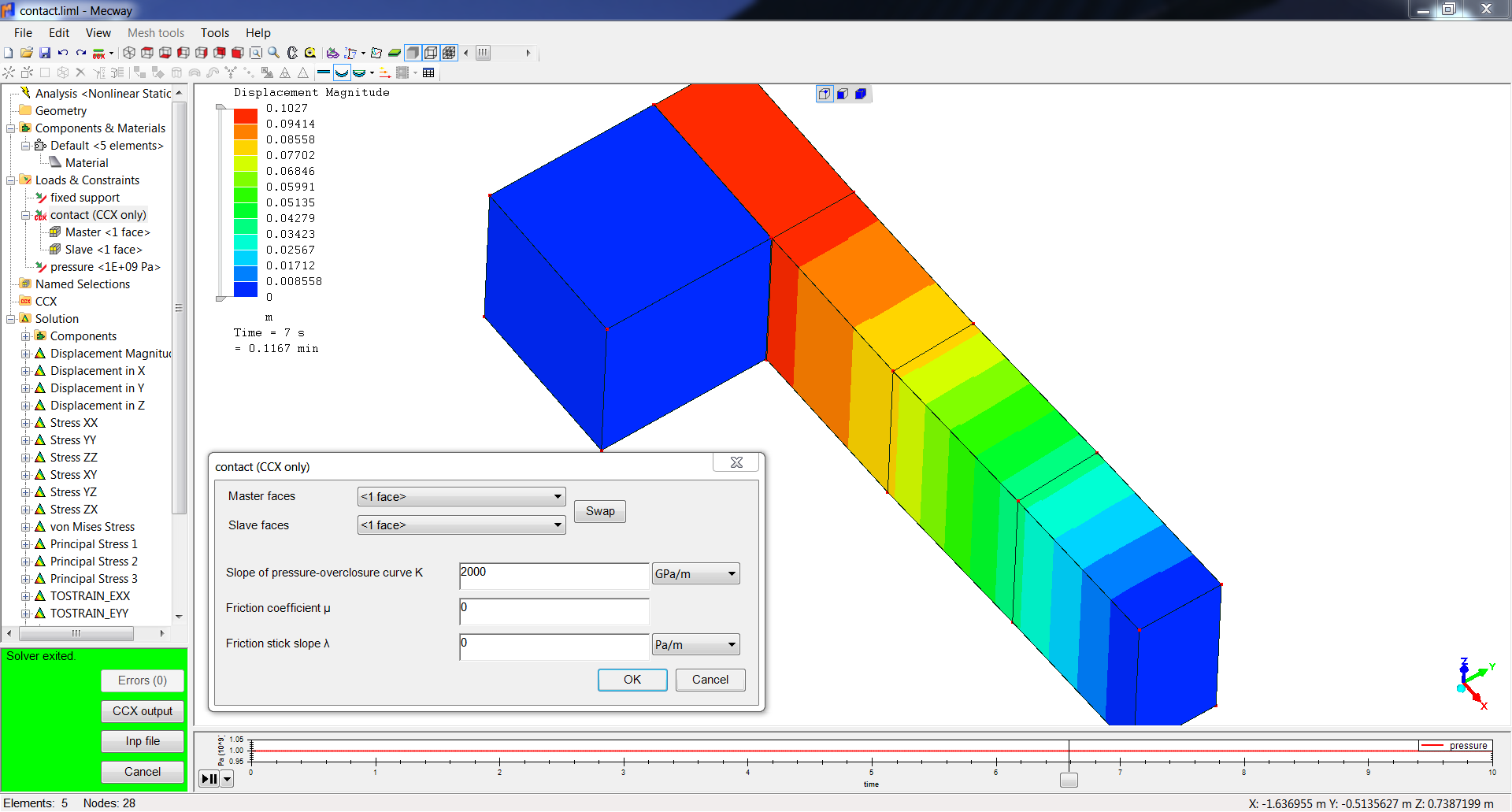

  • Hi, I'm doing some test with hard contact, and I have computed a value for the slope of pressure-overclosure, that make my problem solve. But now I want to start to try with different friction coeficcients, but there is a red warning in the tree telling me that the friction stick slope must be positive for valid friction aplication. Any advice in how to compute this value then?
  • From the CCX manual, it seems to be about an order of magnitude more than the slope of the pressure-overclosure curve. I think I've used the same value for both. That should at least be a useful starting point.
