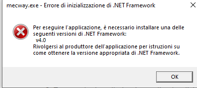

i Have installed the software but i have an error
i Have already installed the .NET framework as you see
How can i do?

Mecway 26 requires .Net Framework 4.8 so please install that. I'm not sure why the error message says 4.0.
Mecway 23 used .Net Framework 4.5 so if it still doesn't work, maybe try that (
https://mecway.com/download/oldversions/mecway230.msi
) to see if the framework version change is the problem.

i installed .net framework 4.8.1 but same error on version 26

i try also Mecway 23 and i have the same problem.
So i uninstall .net framework, check for update win 10.
Reboot the PC
Reinstall the .net framework, rebbot the PC, reinstall Mecway 26 and now is OK
Thanks Victor for your time
