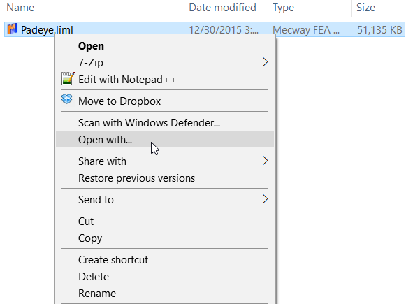

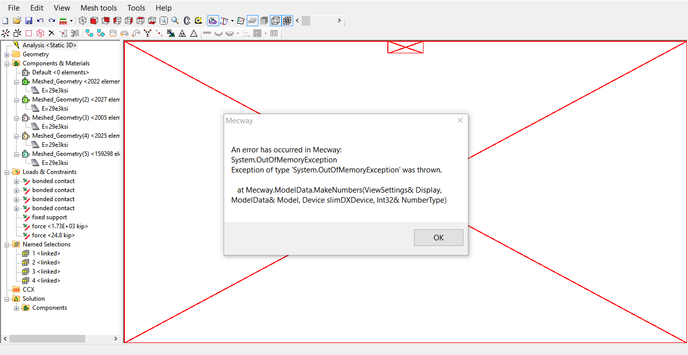

Victor, see attachment for an error message when opening larger model (~300,000 nodes) by double clicking on the file itself. If I open Mecway first (blank) and use file -> open -> select the same file, it opens fine.
Any comments? Thanks
  • Could be that Windows has asociated the file extension with the 32 bits executable of Mecway?

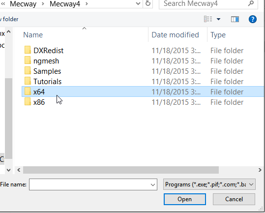

  • I just tried "open with" option by right clicking to select the executable Mecway versions x64 and then x86 (see attachments). Both gave me the same error message. So this is not the case.
  • Thanks for reporting this bug VMH. It's newly appeared in version 4. I can't think of a workaround except don't open big files directly from the icon.
    It also reveals a more longstanding bug - it crashes when you turn on the display of node or element numbers for large meshes.
