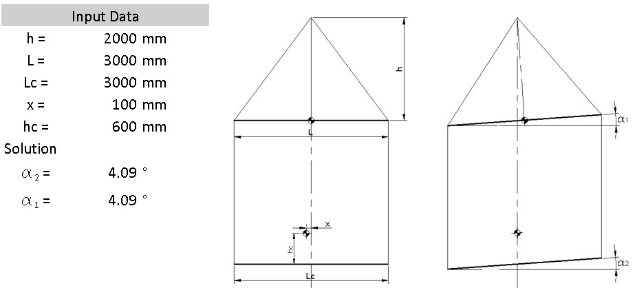

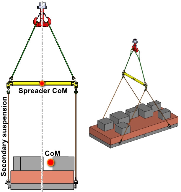

Sometimes I have to evaluate the load inclination (see figure) and if it's acceptable without changing primary suspension slings (from the hook to the spreader beam).
Analitically is not complicated if secondary suspension are vertical (as in the figure) but if they are inclinated inward or outward and beam mass are taken into account is not simple
So I ask what type of analisisys is better for finding equilibrium position and where could be appropriare to apply friction and damping
I started with a simple model where the beam is composed by 2D elements and the load with 3D brick elements. Also slings are considered ad 2D elements (beam elements) because we are sure that there will be no compression

    We are speaking about 3/4° inclination of the spreader beam negleting the beam mass.
    For greater inclination is necessary to change the length of the primary suspension
    I started from the attached model (is like a simple pendulum) where I know what is the equilibrium position

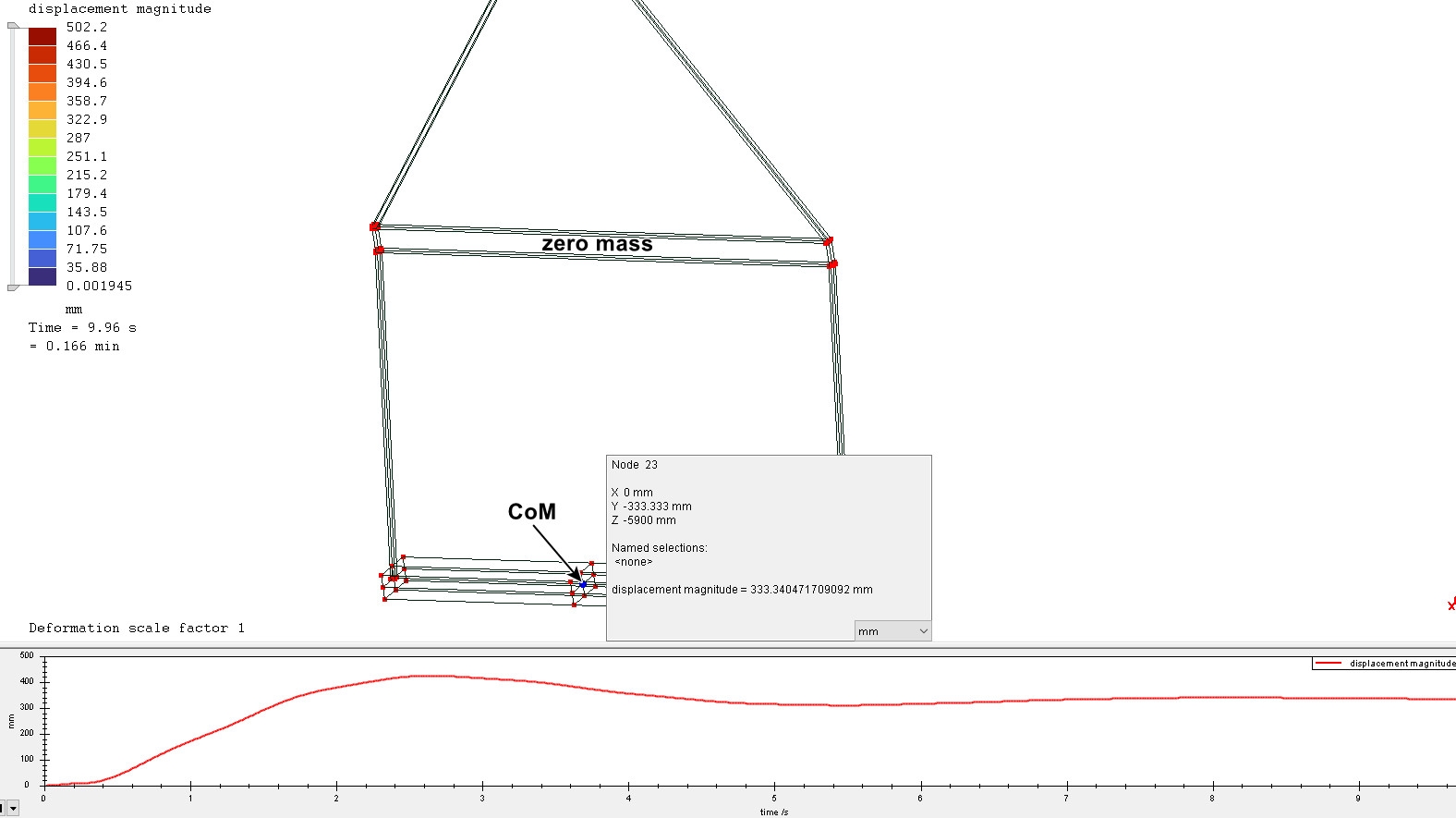

    Guess that you will need to add some damping or friction to the system, otherwise will be balancing constantly.
    Attached two runs, the second is wit Raleigh damping, alpha =0 and beta = 1s
    As I understand with damping the system will finish in the equilibrium position.
  • edited April 23
    I tried to apply Rayleigh damping but not to the rigidity (beta coefficient). I tried with some value of alfa (proportional to the mass) and for this first test I found the equilibrium position with good agreement with the theoretical (sling mass = 0 - CoM of the beam vertical respect the the suspension point)
    Seocond step is to build a model with the load and for this case solution doesn't converge. I will attach another test
    Solution seems to be right....the problem was related to the slings (beam elements) rotations

  • For 2D (plane zy in the simulation) I found an acceptable solution. In the attached model node 28 (CoM) is vertical respect the suspension point. At the end of simulation the node displacement on y direction is very closed to the initial y-coordinate of the node. Other check regard the y coordinates of extreme nodes of the secondary suspension: they have the same y-displacement.
