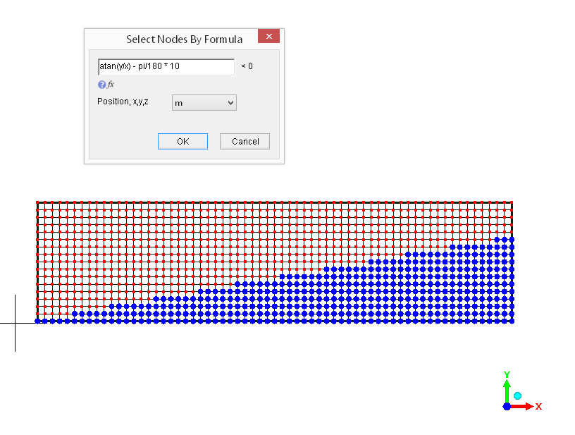

  • Thanks, I will investigate the formulas for selecting. Any advice to create a formula that include the nodes within an angle of by example 10 degrees?
  • To select nodes less than 10 degrees from the X-axis in the +X+Y quadrant, you could use the formula
    atan(y/x) - pi/180 * 10 < 0
    Don't type the "< 0".
