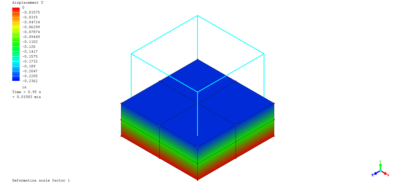

  • My 2 cents. CCX, nonlinear 3D, note settings in Analysis. I used a handy hyperelastic material but your hyperfoam should perform similarly. I ramped your Y displacement, and removed the constraint on the pin surface - if it can slide, it can move normally. You could add the pin and use contact. This ran in 50s so I don't think contact is going to slow you down.
    On your note about "results looked correct" - careful! That has been my entire career, knowing the difference between "results look correct" and "correct results" :D

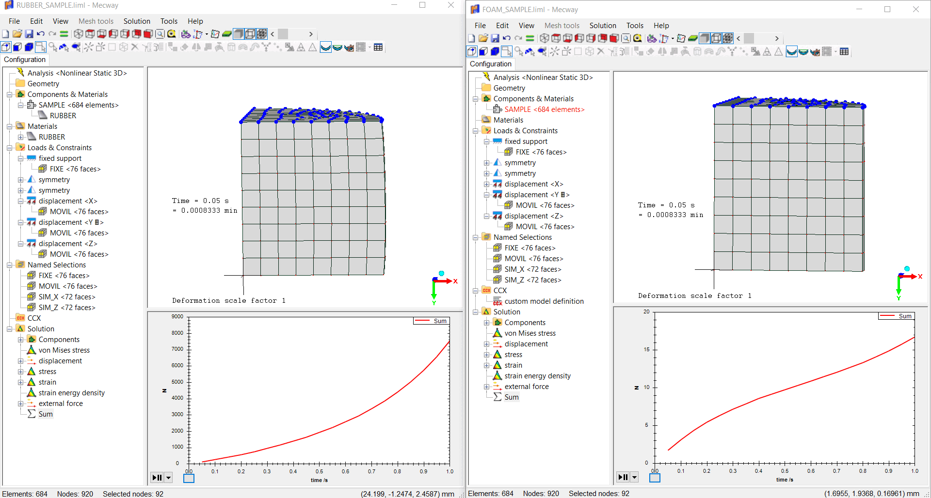

  • For microcelullar rubber I have used in the past (automotive door sealing) Abaqus hyperfoam material. CalculiX also includes this material, take a look at a simple comparation between hyperelastic (solid rubber) and hyperfoam (microcelullar rubber). @Victor, the Solution/Sum feature is great, but can you add the field name to the label of the plot? Something like Sum/External Force/Y
