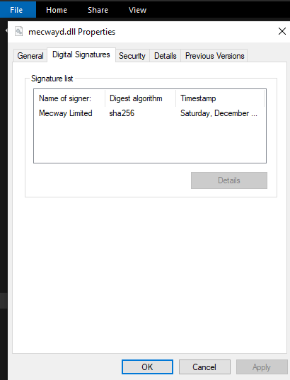

I'm concerned about the digital signature. If mecway240.msi, mecway.exe and mecwayd.dll don't all have valid digital signatures signed by Mecway Limited in February 2024, then they're corrupt or the wrong version. Can you show me what the Properties dialog looks like when it's saying neither OK nor not OK?

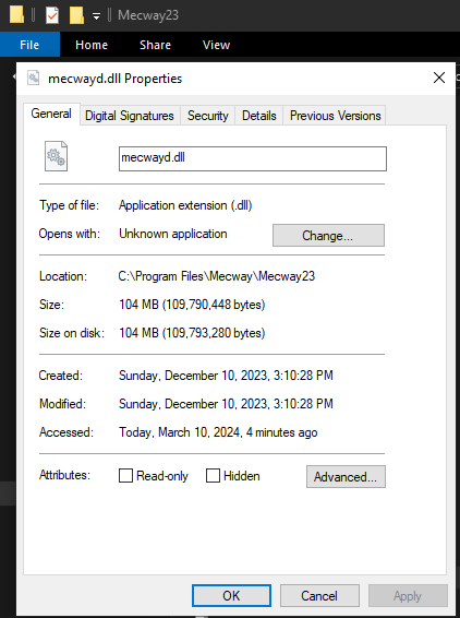

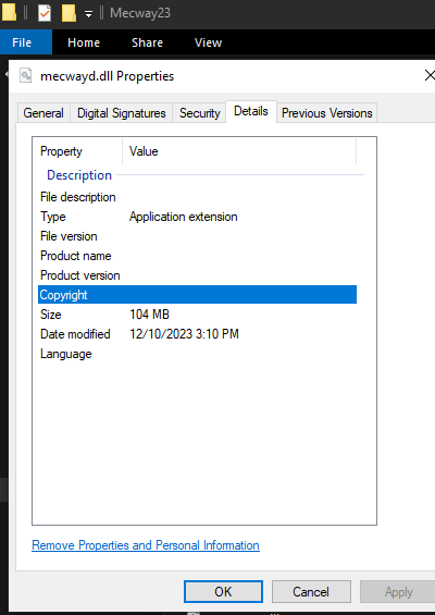

I fresh installed Mecway230 on a new laptop and got the same "Mecwayd.dll" error after launching Mecway. Attached are snapshots of the DLL property as requested:

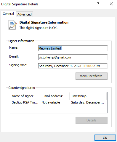

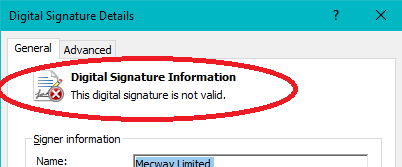

I forgot to say you need to click on the signature in the list that says "Mecway Limited" then the Details button (not tab). Here's what it looks like if it's corrupt:

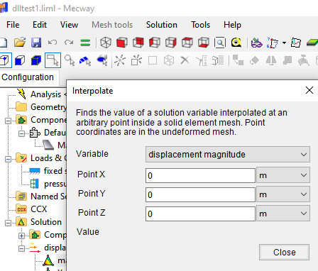

3) Open dlltest1.liml, use Solution -> Interpolate and select displacement magnitude. It should show 1E-06 m or equivalent in other units.

Digital Signature Info for the mecwayd.dll is ok (see attached)

3. Displacement magnitude using Solution Interpolate is 0. not 1.E-6 for dlltest1.liml (got the same error when I solve)

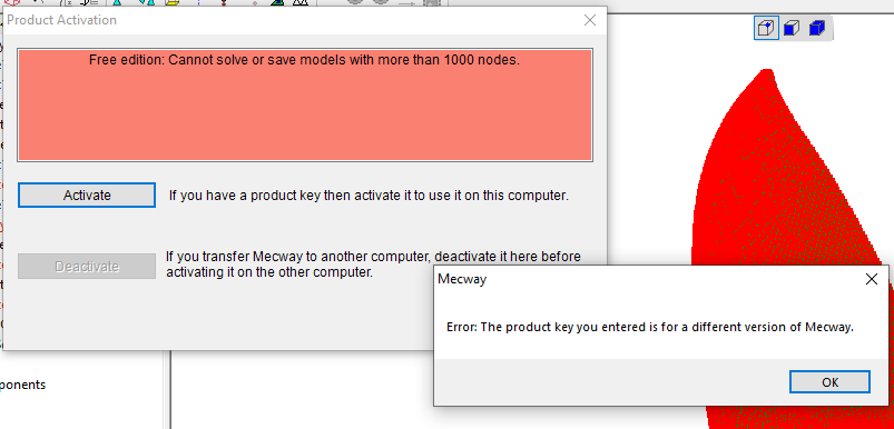

To active Mecway11to run full version, I get the following message once I enter the product key. Any thoughts why I am getting this error message?

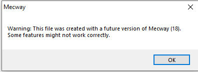

I also ran one of my older models (created in Mecway18). The solver finished successfully without any issues but the natural frequencies were zeros (received version compatibility warning when reading in the model file).
Hope this helps.
Regarding 0 frequencies, there have been a lot of file format changes since then so constraints might have been lost.
Why did I get compatibility warning when I ran V20 with model being created in V18?
