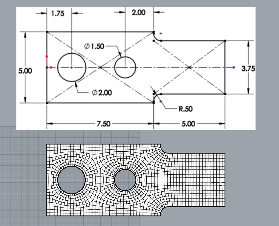

what is the best approach/workflow to make a structured mesh along holes?
This question because I want to replicate the following plate
I've already tried with automatic mesh & points refinement, what I got is here
Then I found the command "Plate mesh" that allows to create a square with circular hole in a structured mesh
So I modified the cad geometry, I put squares boundary edges for the both holes
and the genereted the automatic mesh
I made the plate mesh with the command and moved where I needed
The nodes along the edges are not connected and even with the "merge" command I got disconnected holes
I expected to get something like this
do you have any suggestions?
Thank you
  • Rhino has a great function called quadremesh -for 2d meshes like this it works nicely
  • Thanks for the reply, it's an exceptional result but, not having the Rhino license, I would like to do everything in mecway.
